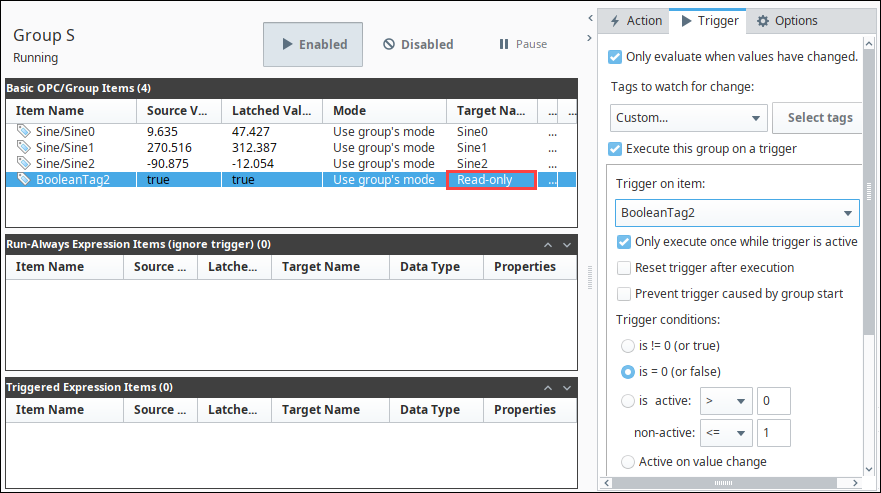

Execute on a Rising Edgeβ
Groups can execute when the trigger becomes True. This is known as a rising edge trigger and it will only execute once and will not execute again until the trigger repeats the same cycle.
- Create a standard Transaction Group with any number of tags as long as one of them is a boolean tag that will serve at the trigger for the group.
- Set the Write Target for the boolean tag to Read-only by selecting read-only from its drop down in the Target Name column. You do not need to do this if you want the trigger value to be written to the database.
- Go to the Trigger tab and select the check box to Execute this group on a trigger. Select the boolean tag from the drop down menu and select to have the group only execute once while the trigger is active.
- Save the Project to start the Transaction Group.
