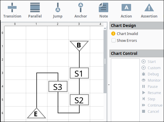

Flow Must Always Lead into the Top of an Element.β
While moving bottom-to-top is legal, flow may never enter the bottom of an element. If the flow leads to the bottom of an element, it is considered a dead-end, and the chart will fail to execute.
The image below demonstrates an illegal Chart. This chart will not execute because the flow from S2 is attempting to lead into the bottom of S3.
