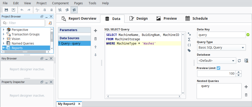

You can use the following code in a static SQL query. The query will return all rows where the value in the MachineType column is 'Washer'.
SELECT MachineName, BuildingNum, MachineID
FROM MachineStorage
WHERE MachineType = 'Washer'

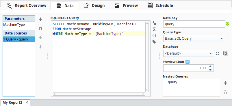

Report Parameters in a Basic SQL Query​
Queries can also be made dynamic using things like report parameters. To insert a report parameter, click the Parameters icon to the right of the query area and select your parameter. This allows for a more dynamic query, since new values can be passed into the parameter at runtime, giving the ability to change the type of machine this query is looking for.
Parameters are inserted directly into a report. This means that the datatype of parameter will affect how it should be referenced in the query. For example, since the parameter MachineType is a string, it will need a single or double quotes around it.
String Parameters
WHERE MachineType = '{MachineType}'

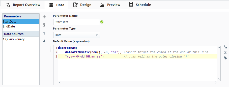

Reformat the Date Parameters​
By utilizing the expression language's dateFormat() function, we can simply specify the format of the date.
SQL - Reformatted Date Parameter
dateFormat(
dateArithmetic(now(), -8, "hr"), //don't forget the comma at the end of this line...
"yyyy-MM-dd HH:mm:ss") //...as well as the outer closing ')'

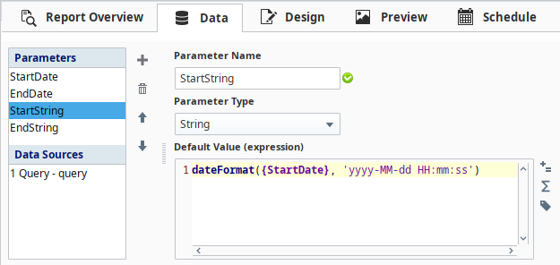

Create New Formatted Parameters​
In some cases, you may wish to leave the original "raw" Date parameter alone, and create a display-friendly version as a string.
To do this, simply make a parameter with type string and use the dateFormat() expression on a date. In the image below, you can see that the StartDate parameter is used in a new StartString parameter. Additionally, an EndString parameter has been created that is using the EndDate parameter. This way, we can bind a calendar component directly to the Start and EndDate parameters and all the formatting will be done automatically in the report.

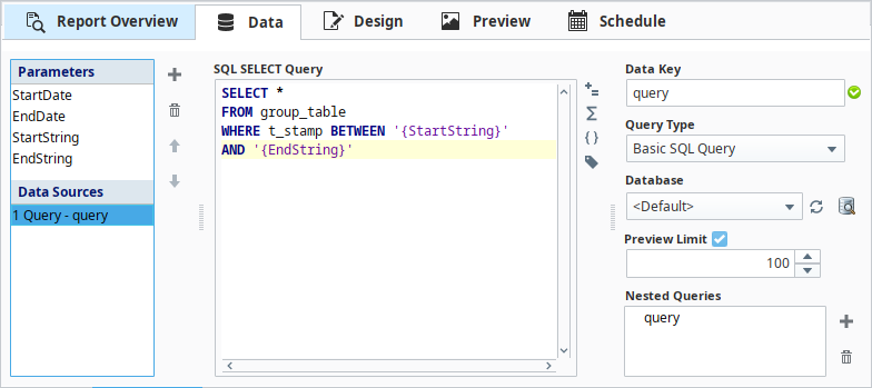

Once the new string parameters have been created, we can then reference them in the Basic SQL Query just like a normal string.
SELECT *
FROM group_table
WHERE t_stamp BETWEEN '{StartString}'
AND '{EndString}'
