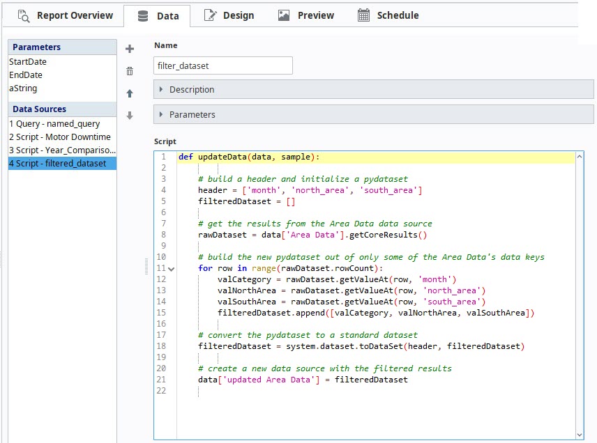

Say we have a query data source named "Area Data" which contains four columns: month, north_area, south_area, and t_stamp. If we need to build a new data source without the t_stamp column, we can use the following code:
Python - Building a New Data Source
# build a header and initialize a pydataset
header = ['month', 'north_area', 'south_area']
filteredDataset = []
# get the results from the Area Data data source
rawDataset = data['Area Data'].getCoreResults()
# build the new pydataset out of only some of the Area Data's data keys
for row in range(rawDataset.rowCount):
valCategory = rawDataset.getValueAt(row,'month')
valNorthArea = rawDataset.getValueAt(row,'north_area')
valSouthArea = rawDataset.getValueAt(row,'south_area')
filteredDataset.append([valCategory,valNorthArea,valSouthArea])
# convert the pydataset to a standard dataset
filteredDataset = system.dataset.toDataSet(header, filteredDataset)
# create a new data source with the filtered results
data['updated Area Data'] = filteredDataset
