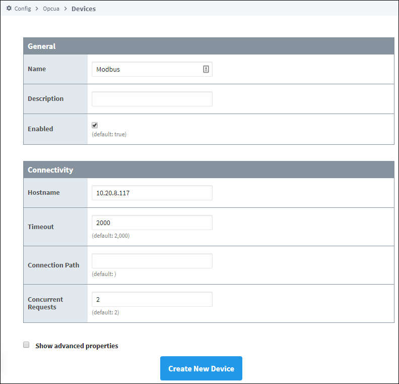

  5. On the New Device page, leave all the default values and type in the following fields:
    • Name: Modbus
    • Hostname: Type the IP address. For example, 10.20.8.117.
    Connecting to Modbus Step 5
  6. You can check the box for Show advanced properties to see the additional settings, or you can keep all the defaults.
  7. Click Create New Device. The Devices page is displayed showing the Modbus device is successfully created and added to Ignition. The Status will show as Disconnected and then Connected.
