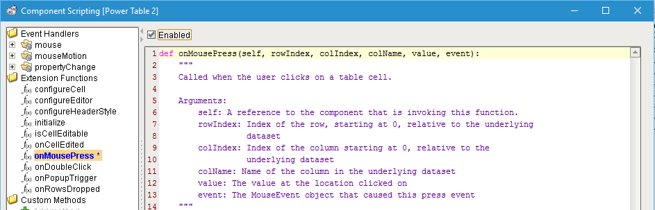

onMousePress and onDoubleclick​
onMousePress Extension Function
onDoubleClick Extension Function
The onMousePress extension function allows to define actions for single left click event. The onDoubleClick extension function allows to define actions for the double left click event. Note that on systems using touch screens the double-click may not be available. Make sure to use these function (not the mouseClicked event handler function) for single or double left click events for better reliability, and to future-proof your code.
PurposeCode
If the length of the URL string with surrounding white space removed in the table's "URL" column is greater than 0, open that URL in the Web Browser component when the URL is clicked.
