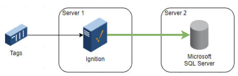

Standard Architecture​
Latency (Server 1 to Server 2)
Dropped Packets0ms1ms5ms10ms20ms50ms100ms150ms200ms
0%2243322---
2%2243322---
5%101111----
10%1--------
15%---------
20%---------
