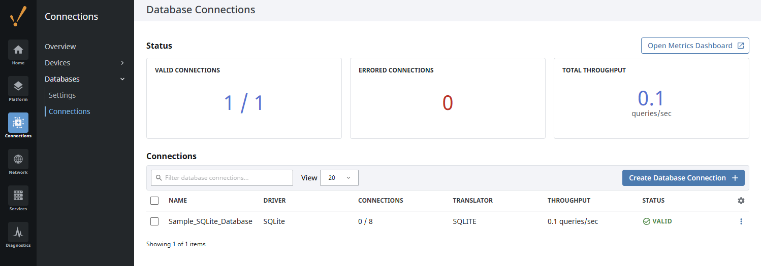

The first step in dealing with slow queries is identifying which query is actually running slowly. A good indication of the query location is when a window is opened and a component takes time before database data is displayed. Chances are the query is on that component somewhere. However, it may also be a good idea to check the queries that are being run against that database connection in the Gateway. From the Gateway, navigate to Connections > Databases > Connections to see a list of all database connections. From here, you can get a good idea of any queries that may be a little slower than the others.

First, check to make sure the database connection is valid, and there are no warnings associated with it. You may want to go into the connection settings for that database and take note of the value of the Max Active property, which determines the maximum number of active connections to the database, as well as the Max Wait property, which is the number of milliseconds to wait for a connection to come available. To get to the database connections settings, navigate to Connections > Databases > Connections, locate your database, and expand the three dots menu to select Edit. Here, you can check the database settings. Open Advanced Properties at the bottom of the panel, and you'll find the Max Active property as well as the Max Wait property.
Check Currently Executing Queries​
On the Database Connections page, we can see a list of currently running queries, as well as how many of the active connections are being used. If the max number of connections is being used, it may be that there are so many queries running that each query needs to wait for an active connection to open up. If this is the case, you may want to increase the amount of active connections to the database or take steps to reduce the query load on the database.
