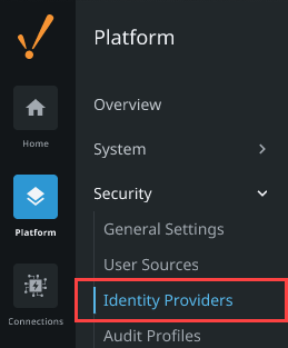

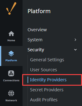

  1. On the Gateway Webpage, click on the Platform tab. You will need to log in if you aren't already.
  2. Under the Security section, click on Identity Providers. The Identity Providers screen is displayed. This screen will list all IdPs that have been configured. You can filter by name or adjust the number of IdPs displayed per page in the view.

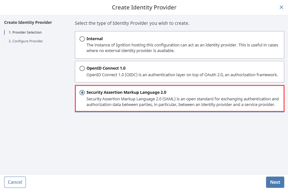

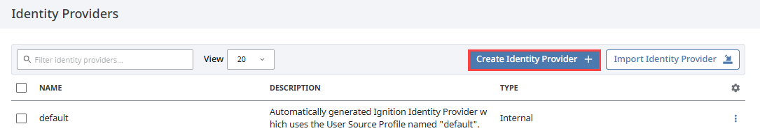

  3. Click on the Create Identity Provider + link.
  4. Select the Security Assertion Markup Language 2.0 option and click Next.

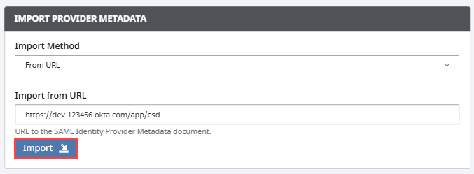

  6. The next section is Import Provider Metadata. In the Import from URL section, enter in the URL from earlier specific to your IdP. You can also import a file below if it was provided by your IT department.
  7. Click on the Import button.

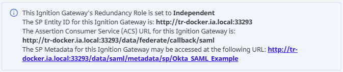

  8. Ignition will now generate a URI redirect address for your Ignition server. It is listed just below the “Import Provider Metadata” area of the configuration form. In our example it is http://10.10.110.86:8088/data/federate/callback/saml. You need to provide this URI to your IdP (usually this means giving it to your IT department).
note
The URI should be a web address that is accessible from the IdP server.
  1. Once you have given your IT department the redirect address, they can add your Ignition server as an application to the IdP.
note
The IdP can use the same redirect address for the Login, Logout, and Initiate Login.
