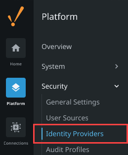

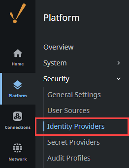

  1. On the Gateway Webpage, click on the Platform tab. You will need to log in if you aren't already.

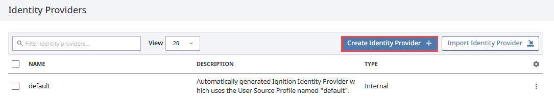

  2. Under the Security section, click on Identity Providers. The Identity Providers screen is displayed. This screen will list all IdPs that have been configured. You can filter by name or adjust the number of IdPs displayed per page in the view.
  3. Click Create Identity Provider +.

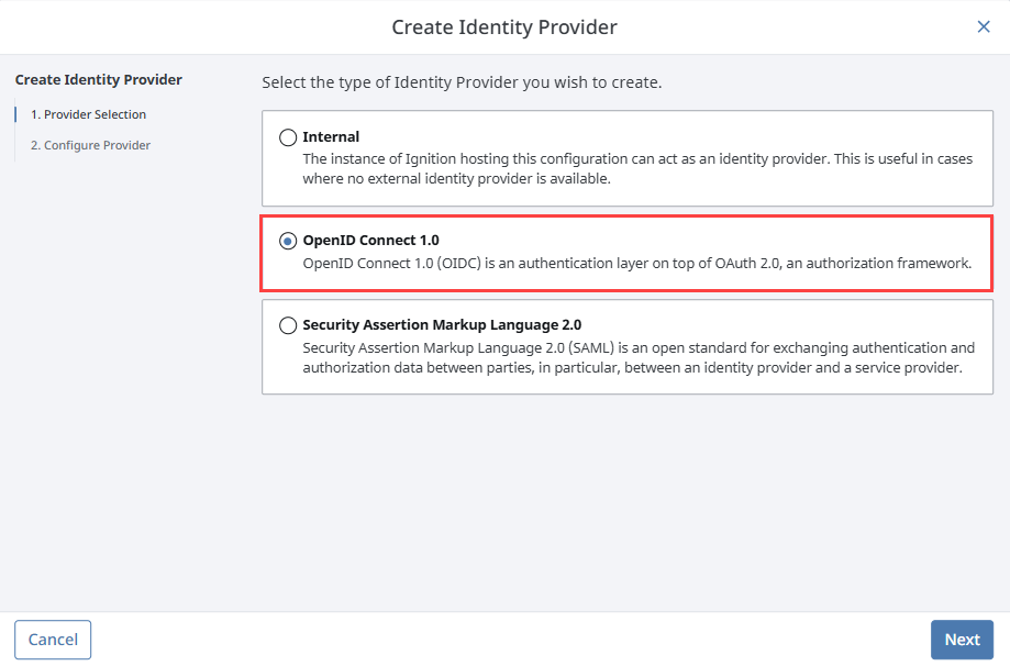

  4. Select the OpenID Connect 1.0 option and click Next.

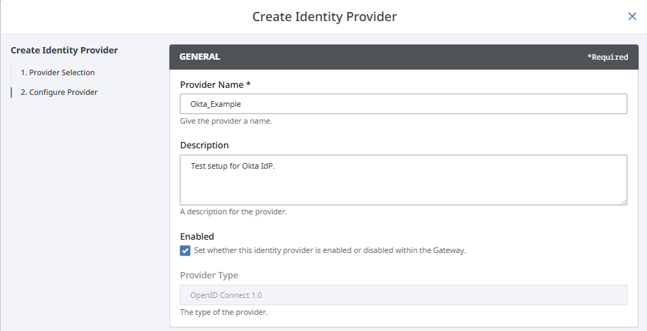

  5. On the Basic Details screen, provide an Provider Name. You can also add an Provider Description if desired. The Provider Type field will fill in automatically from the previous screen.

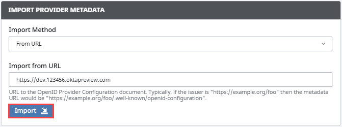

  6. The next section is Import Provider Metadata. In the Import from URL section, enter in the URL from earlier that shows the “.well-known/openid-configuration” link specific to your IdP. You can also import a file below if it was provided by your IT department.
  7. Click on the Import button.
