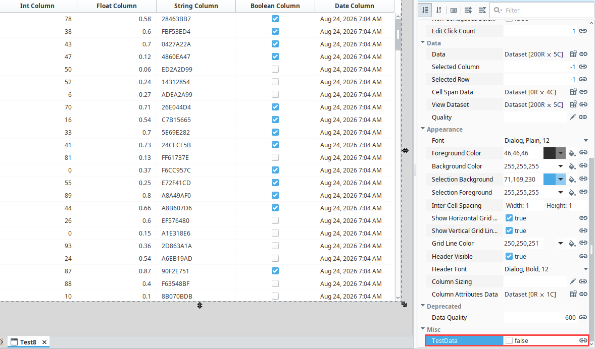

Vision Example​
  1. Drag a Power Table component on to your window and toggle its TestData property to generate some data.

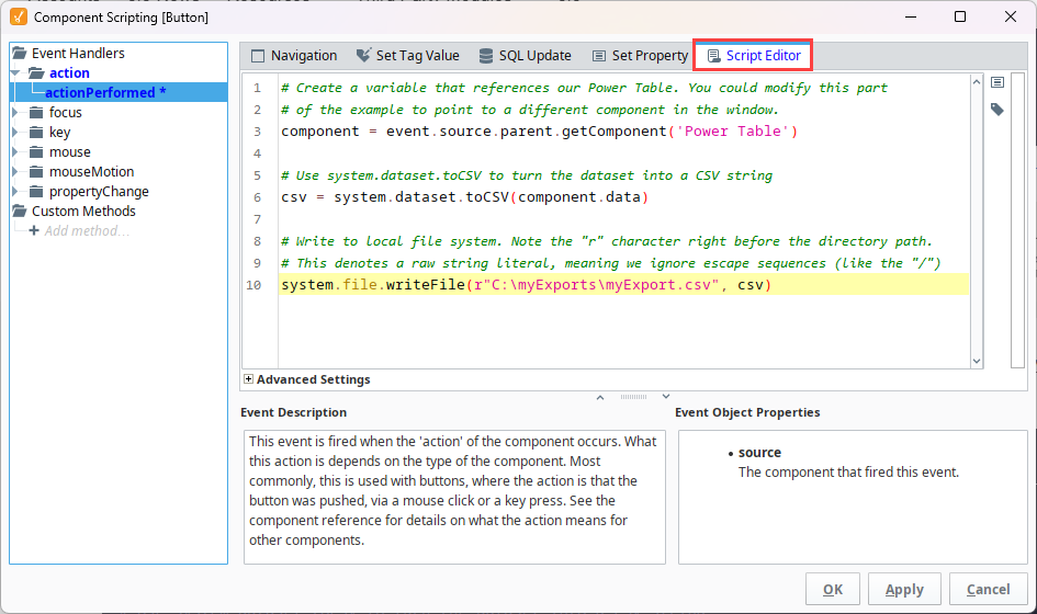

  2. Drag a Button component on the window, and select Scripting from the Button's right-click menu to open the Component Scripting popup.
  3. Select the action > actionPerformed event, and click on the Script Editor tab.
  4. Copy the example script below, and paste the contents to the Script Editor.
    Hard Coded Filepath
    # Create a variable that references our Power Table. You could modify this part
    # of the example to point to a different component in the window.
    component = event.source.parent.getComponent('Power Table')
    # Use system.dataset.toCSV to turn the dataset into a CSV string
    csv = system.dataset.toCSV(component.data)
    # Write to local file system. Note the "r" character right before the directory path.
    # This denotes a raw string literal, meaning we ignore escape sequences (like the "/")
    system.file.writeFile(r"C:\myExports\myExport.csv", csv)

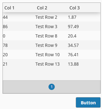

Perspective Example​
This example will demonstrate how to generate a CSV file from a Table component that contains a dataset. Note that you can run the script in this example using the default data for a Table component, but since it is a JSON array structure and not a dataset, the CSV file format will result in a single row of data.
  1. Drag a Table component to your view.
  2. Right-click on the data property and select Change to > Value.
    "ds",
    192,
    1787772403105
    "$columns": [
    "name": "Col 1",
    "type": "Integer",
    "data": [
    44,
    86,
    0,
    78,
    20,
    21
    "name": "Col 2",
    "type": "String",
    "data": [
    "Test Row 2",
    "Test Row 3",
    "Test Row 8",
    "Test Row 9",
    "Test Row 10",
    "Test Row 13"
    "name": "Col 3",
    "type": "Double",
    "data": [
    1.8713151369491254,
    97.4913421614675,
    20.39722542161364,
    34.57127071614745,
    76.41114659745085,
    13.880548366871926
    Col 1Col 2Col 3
    44Test Row 21.87
    86Test Row 397.49
    0Test Row 820.4
    78Test Row 934.57
    20Test Row 1076.41
    21Test Row 1313.88

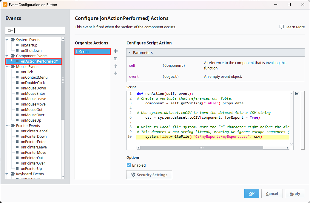

  3. Drag a Button component to the view, and select Configure Events from the Button's right-click menu to open the Event Configuration popup.
  4. Select Component Events > onActionPerformed.
  5. Click the Add icon and select Script.
  6. Copy and paste the script example below into the Script field.
    Exporting Data
    # Create a variable that references our Table.
    component = self.getSibling("Table").props.data
    csv = system.dataset.toCSV(component)

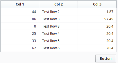

Vision Example​
  1. Create a text file on your local system named example.csv containing the CSV file Content data.
  2. Add a Power Table and a Button component to your window.

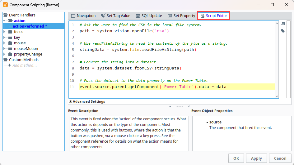

  3. Select Scripting from the right-click menu for the Button component, and paste the following code into the Script Editor of the actionPerformed event:
    Python - Using system.dataset.fromCSV()
    # Ask the user to find the CSV in the local file system.
    path = system.vision.openFile("csv")
    # Use readFileAsString to read the contents of the file as a string.
    stringData = system.file.readFileAsString(path)
    # Convert the string into a dataset
    data = system.dataset.fromCSV(stringData)
    # Pass the dataset to the data property on the Power Table.
    event.source.parent.getComponent('Power Table').data = data

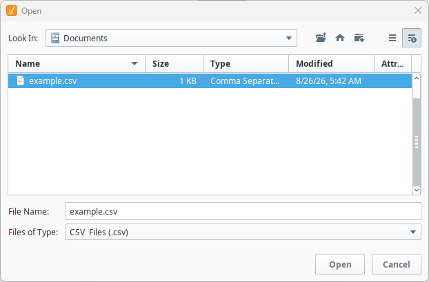

  4. Put the Designer into Preview Mode, and click the Button.
  5. A window will open for you for you to navigate and choose your CSV file, then click Open.
Your data will be displayed in the Power Table as shown below.

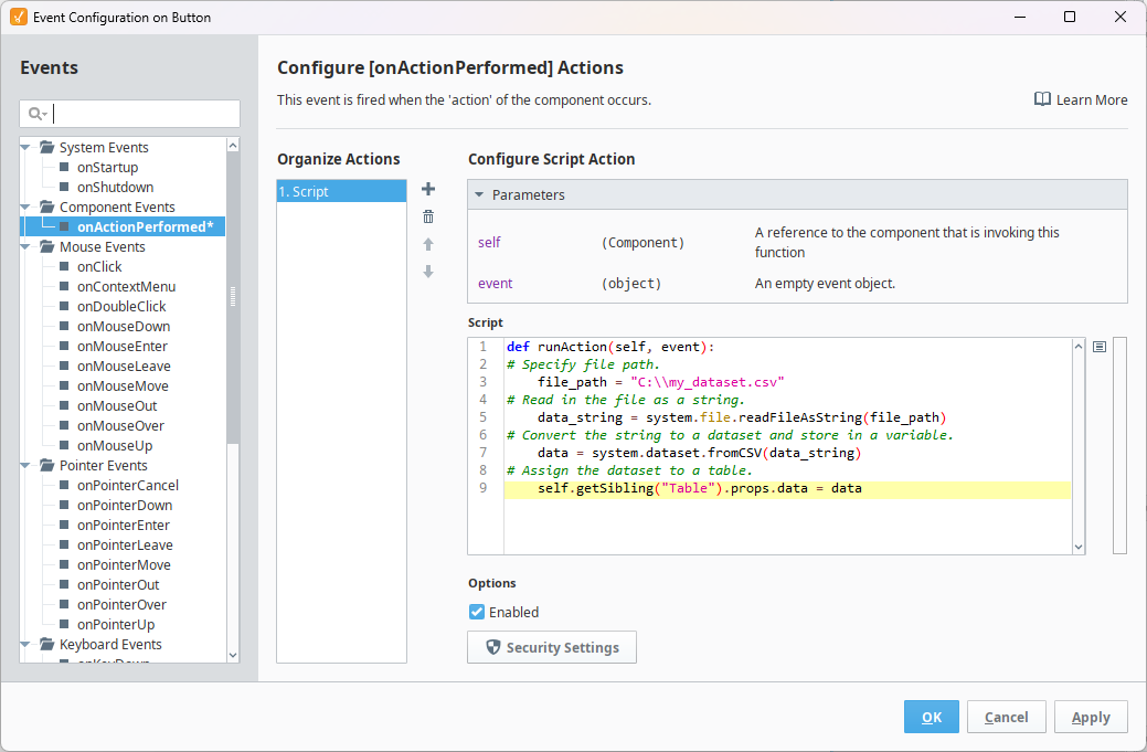

  3. Select Configure Events from the Button's right-click menu to open the Event Configuration popup.
  6. Paste the following code into the Script Editor of the actionPerformed event:
    # Specify file path.
    file_path = "C:\\my_dataset.csv"
    # Read in the file as a string.
    data_string = system.file.readFileAsString(file_path)
    # Convert the string to a dataset and store in a variable.
    data = system.dataset.fromCSV(data_string)
    # Assign the dataset to a table.
    self.getSibling("Table").props.data = data
