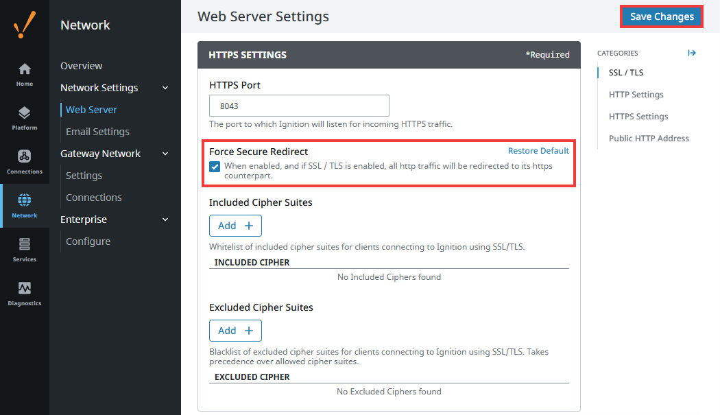

Enabling Force Secure Redirect​
Normally, Clients, Sessions, Designers, and web browsers that communicate with the Gateway will do so over an HTTP. However, you can force these communications to be redirected to the more secure HTTPS.
  1. Go to the Network section of the Gateway Webpage.
  2. Choose Network Settings > Web Server.
  3. Select the checkbox for Force Secure Redirect under the HTTPS Settings, and click Save Changes at the top of the page.
    Enabling Force Secure Redirect Step 3
When enabled, all requests between the host Gateway and any Clients, Sessions, Designers, or web browsers will be redirected to the HTTPS port (by default, port 8043), and thus encrypted. However, you will likely want to install a security certificate signed by a certificate authority.

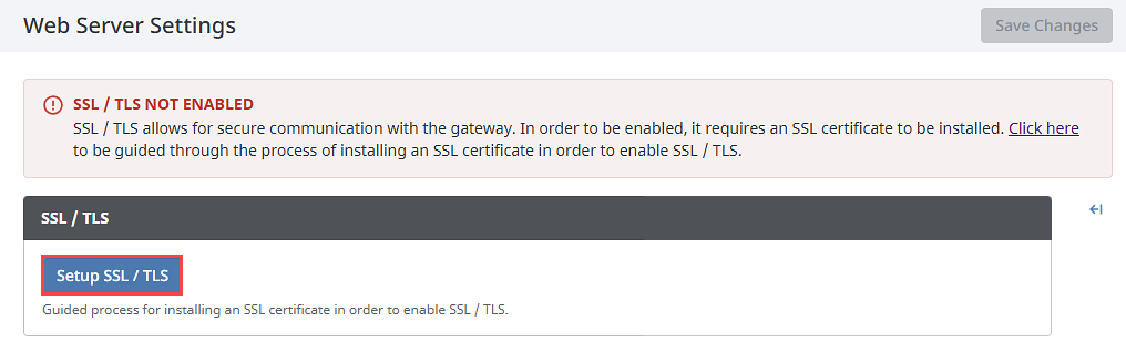

  1. Go to the Network tab of the Gateway and select Network Settings > Web Server.
  2. You'll see a warning message indicating that SSL/TLS is not enabled.
  3. Click on Setup SSL/TLS.

  1. Go to the Network tab of the Gateway Webpage and choose Network Settings > Web Server.
  2. You'll see a warning message indicating that SSL/TLS is not enabled. Click on Setup SSL/TLS

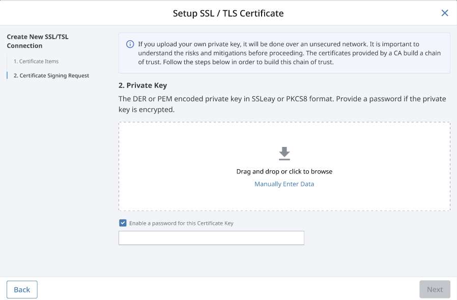

  5. Import your private key, selecting Manually Enter Data to type in the private key information.
  6. If the private key is encrypted, click the checkbox to enable a password for this certificate and enter the password in the field.
    Install Security Certificates Step 5

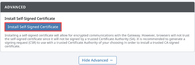

How to Install a Self-Signed Certificate​
  1. Go to Network section of the Gateway.
  3. Under General, click on Setup SSL/TLS.
  4. Select No I don’t have all the items above.
  5. Under the Main section, fill in all of the required fields (*). This includes the Common Name, Organization Name, Organization Department, and Country.
    note
    The Common Name is typically what you input into your browser URL bar in order to navigate to this Gateway. If you do not have a dedicated domain for your Gateway, use the IP address.
  6. Under Subject Alternative Names (SANS), enter in the IP Address along with any DNS associated with your Gateway server.
  7. Select Show Advanced and click Install Self-Signed Certificate.
    How to Install a Self-Signed Certificate Step 7
  8. This will take you to a page that displays the privacy warning that all connections will now see.
    How to Install a Self-Signed Certificate Step 8
