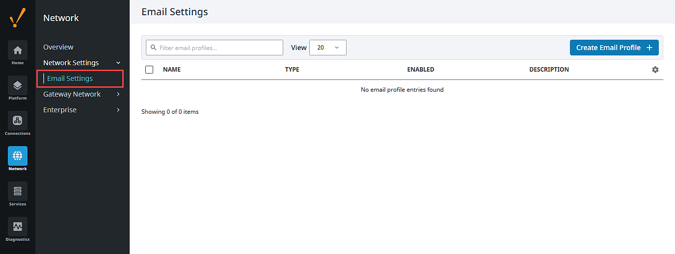

The Email Settings page allows you to select either Classic SMTP or OAuth 2.0, and configure an Email Profile from there. These Email Profiles can be used by several different resources in the Gateway. You can find the Email Settings in the Network section of the Gateway under the Network Settings section. Here, you can create a new Email Profile or manage your existing profiles.

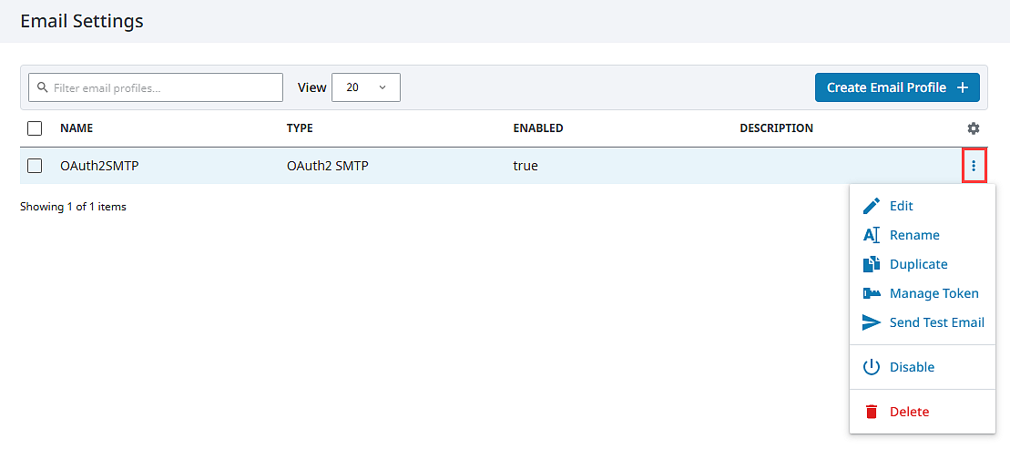

Once you set up OAuth2 SMTP Email Profile, you will have options to manage your token, delete the SMTP Profile, or test it by composing and sending a test email. These options are all available by expanding the three dots menu for the profile.

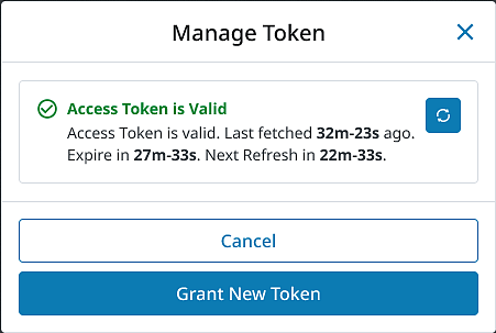

You can view the current state of the access token managed by the OAuth2 SMTP Email Profile from the Email Settings page. If the Email Profile has any issues obtaining or refreshing tokens, details about the issue(s) will be shown here. You can grant a new access token or refresh an access token to attempt to correct any issues. In some cases, you may need to adjust your Email Profile configuration settings to fix a problem.
note
The Refresh Token option will only be available if the OAuth2 SMTP Email Profile is not interactive or if it is interactive and a refresh token is available. Additionally, the Grant New Token option will only be available when the Email Profile is interactive.
The Grant New Token option will allow you to grant the Client a new access token, or refresh the current token and it's expiration time.

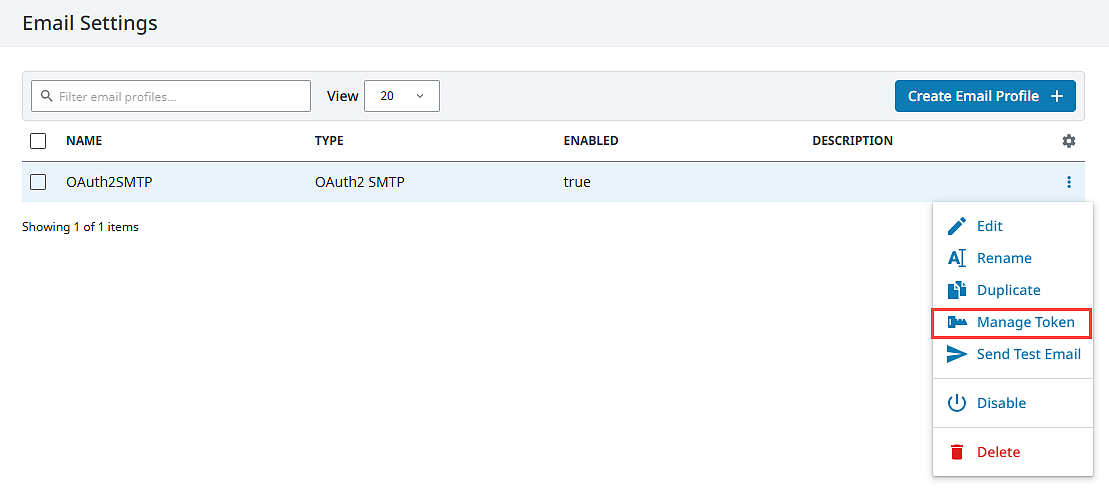

  1. Click on the three dots menu for the OAuth2 SMTP Email Profile and select Manage Token.
    Manage Token Example Step 2
  2. If you are using an interactive-based token, your access token will show as invalid the first time you click on Manage Token. To fix this, click Grant New Token.
    Manage Token Example Step 3
  3. Since we are using a Google Email Profile, we are redirected to a Google permission prompt. Click Allow to continue.
    Manage Token Example Step 4
  4. After the authorization server grants the initial access token, you will be redirected back to the Gateway, After a few seconds, the Gateway will refresh, showing a valid access token.

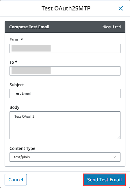

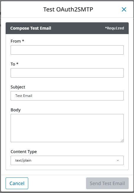

  2. This will open a form where you can compose your test email.
    Test OAuth2 Email Profile Example Step 2
  3. Fill out the form. The From field should be populated with the email address that will be sending the email, and the To field should be the test email's recipient. Click on Send Test Email when you are done.
    Test OAuth2 Email Profile Example Step 3
  4. If the email sent successfully, you will receive a success message.
