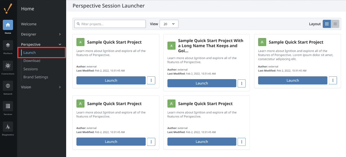

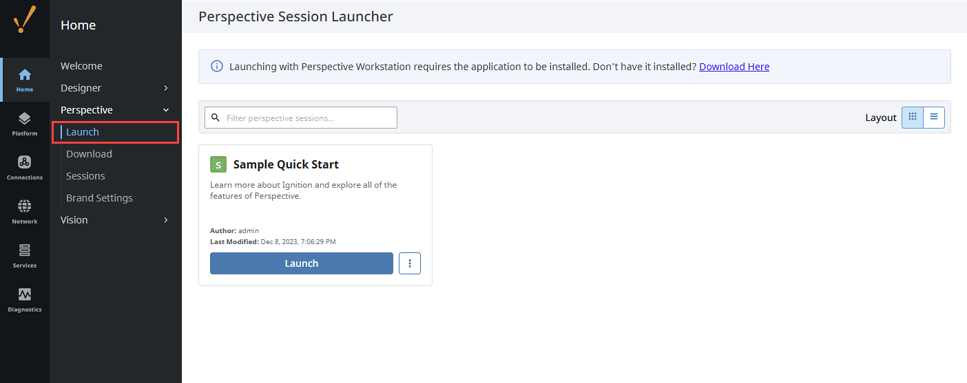

Launch​
The Launch page will list all available Perspective projects with their description, author, and last modified date. Use the grid and list view icons on the upper right-hand side to switch the project layout. Project listings can additionally be filtered by included information as needed.

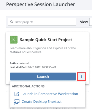

Select Launch to open a Perspective Session. Options for launching the project in Perspective Workstation or creating a desktop shortcut can be found by expanding the three dots menu.

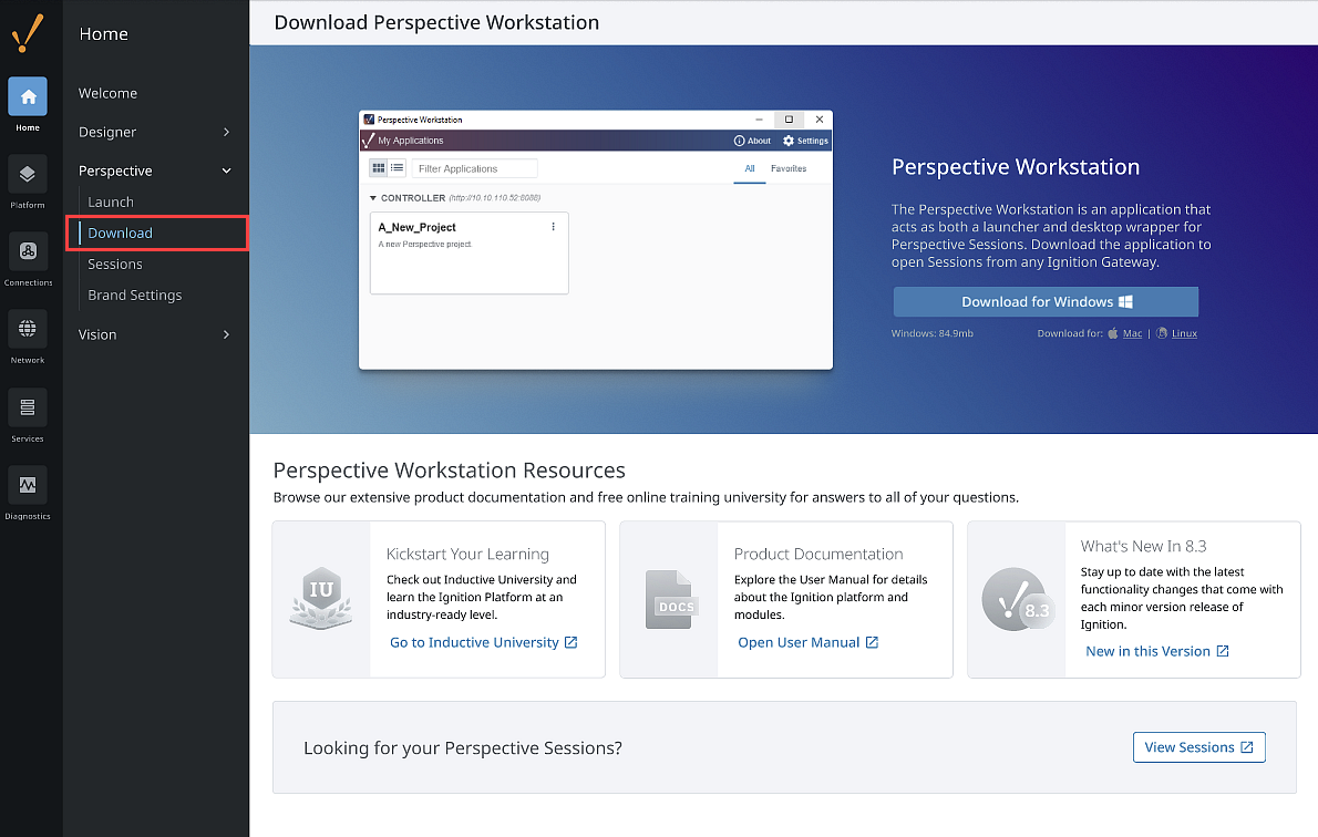

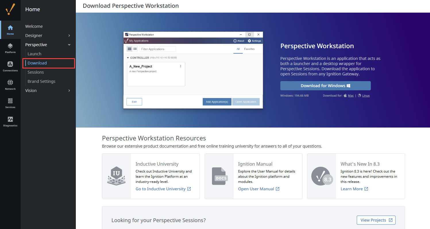

Download​
The Download page allows users to download Perspective Workstation install .exe files to their local machine. The download presented will be for the local operating system, but you can use the links directly below the large Download button to choose alternative operating systems.
Aside from download options, this page also includes links to additional resources like Inductive University. Selecting the View Projects link at the very bottom of the page will navigate to the Sessions page.
Note that if the Perspective Workstation download is unavailable, a warning notification banner will appear.
