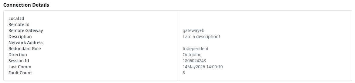

Connection Details​
Gateway Network Connections Details Connection Detail
AttributeDescription
Local IdID of the local Gateway.
Remote IdID of the remote Gateway.
Remote GatewayName of the Gateway on the Gateway Network.
DescriptionA description of the Gateway Network connection.
Network AddressPhysical address used to communicate with all devices on the Gateway Network.
Redundant RoleThe redundancy role of the Gateway. Can either be Independent, Backup, or Master.
DirectionThe direction of the Gateway Network connection. Can either be Incoming or Outgoing.
Session IdGateway connection session ID number. Connected Gateways use the same session ID on both Gateways.
Last CommThe time of the last communication with the Gateway.
Fault CountNumber of times the connection has faulted since the Gateway has been started.

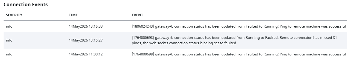

Connection Events​
Gateway Network Connections Details Connection Events
SeverityThe level of the recorded connection event.
TimeThe date and time during which the connection event occurred.
EventThe description of the connection event that occurred.

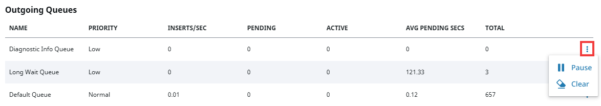

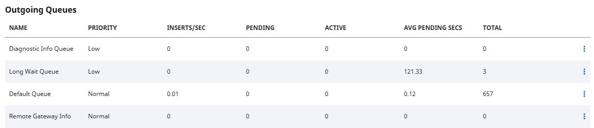

Outgoing Queues​
The Outgoing Queues section displays metrics for different waiting queues Ignition uses to send and receive data. Tasks within each queue are also shown by the number of pending and active tasks. A pending task is a task that has not yet been dispatched to the Gateway Network thread pool. An active task is a task that is being processed by the Gateway Network thread pool and will show up under the Connection Details page as either an outgoing or incoming task.
Remote Gateways Details Outgoing Queues
NameName of the queue.
PriorityLevel of priority for a queue.
Inserts/SecRate of task inserts per second for a queue
PendingNumber of pending tasks in a queue that have not yet been dispatched to a Send/Receive thread.
ActiveNumber of messages being actively processed by the Gateway Network connection.
Avg Pending SecsAverage number of seconds that a task has been pending in a queue.
TotalTotal number of tasks executed from this queue.
Each individual queue can be paused and resumed, or cleared entirely by selecting the three dots menu for the intended queue. Pausing a queue means no new tasks will be allowed to be inserted into the paused queue. Clearing a queue means that all pending tasks will be purged. These actions are designed to help the user deal with a possibly overloaded Gateway Network connection due to a specific subsystem flooding the queue with more tasks than the connection can handle. Note that neither of these actions will have any effect on active tasks, as they have already been dispatched to the Gateway Network connection and cannot be cancelled.

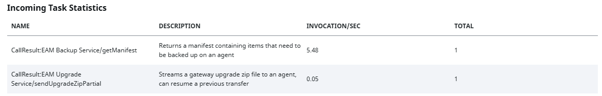

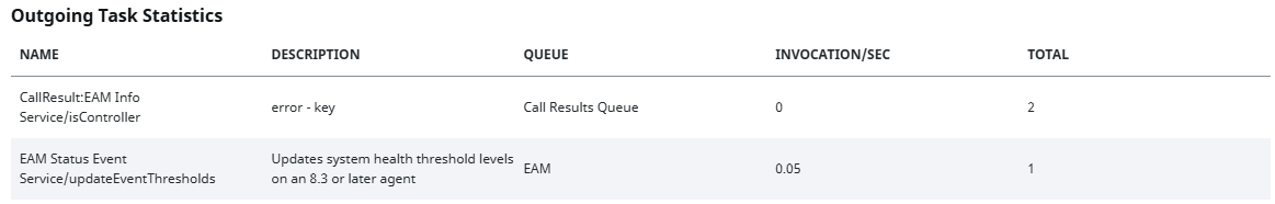

Outgoing and Incoming Tasks Statistics​
The Outgoing and Incoming Task Statistics section shows individual tasks that have been processed by the Gateway Network connection.
Remote Gateway Outgoing Task Statistics
Remote Gateway Incoming Task Statistics
Outgoing and Incoming Tasks AttributesDescription
NameName of a task.
DescriptionDescription for a task.
QueueQueue invoking a task. Used for Outgoing Tasks only.
Invocation/SecRate at which a task is invoked per second.
TotalNumber of times the task has been executed in total.
