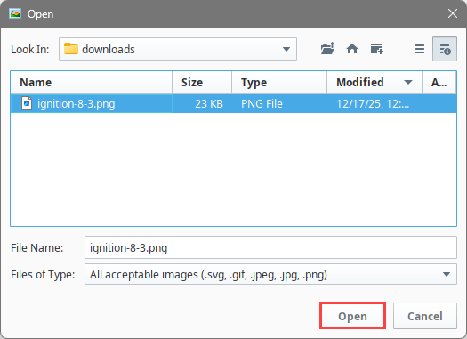

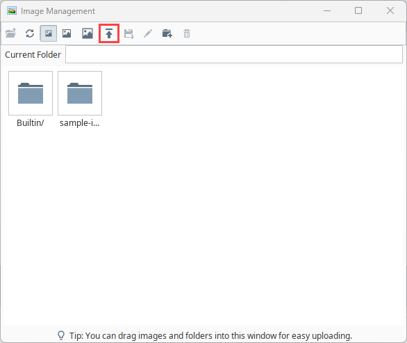

You can upload images by dragging one or more image files or folders from your local file system directly into the Image Management tool, or by using the Upload icon to select images from your local file system.
  1. Click the Upload icon on the toolbar.
  2. Select one or more image files from their current directory on your local file system and click Open.

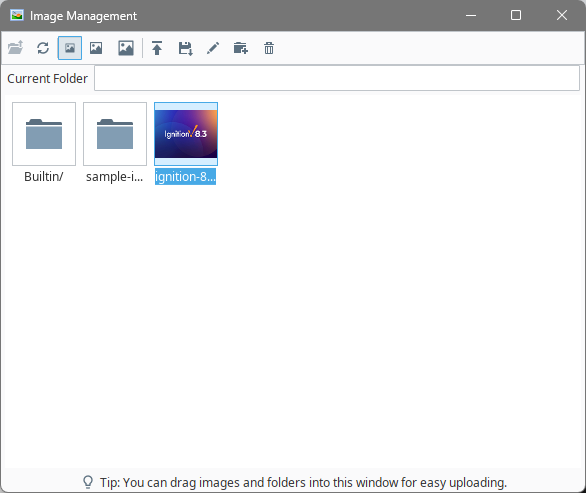

Once the upload completes, the images appear in the Image Management tool.

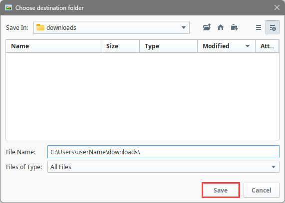

Downloading Images​

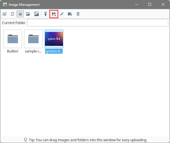

You can also download individual images or entire folders using the Image Management tool. This is useful when migrating image resources to another Gateway or creating local backups.
  1. In the Image Management tool, select one or more images or folders.
  2. Click the Download icon from the toolbar.
  3. Choose a download location on your local file system and click Save.

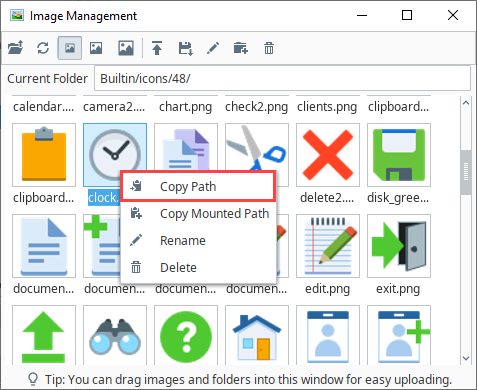

Copying Image Paths​
You can right-click an image in the Image Management tool to access options for copying image paths.
  • Copy Path copies the project-relative image path.
  • Copy Mounted Path copies a mounted path suitable for use in Perspective components.
