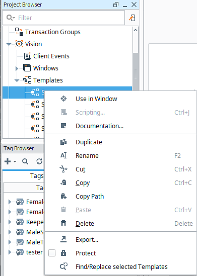

Templates are a project resource. As such they can be copied, duplicated, protected and more. There are several actions available with a right click menu.
ActionDescription
Use in WindowPlaces the selected template on the current window.
Scripting...Opens the Component Scripting Window where you can set scripting on this template. For more information, see Script Builders in Vision.
Documentation...Opens a popup window where you can make notes about the template.
DuplicateDuplicates the template in the Templates folder.
RenameRenames the template.
CutCuts the template, but leaves it on the clipboard.
CopyMakes a copy of the template on the clipboard.
Copy PathCopies the path to the template and places it on the clipboard.
PastePastes a template that's currently on the clipboard.
DeleteDeletes the selected template.
ExportOpens export Project Resources window. where you can export this template and other resources. For more information, see Project Export and Import.
ProtectOnce a project resource protected, it cannot be changed except by someone that has the permission to unprotect it, and modify it. For more information, see Project Security in the Designer.
Find/Replace selected TemplatesOpens a popup window to search your selected template(s) for specific resources. You can then use the replace feature to make changes.
