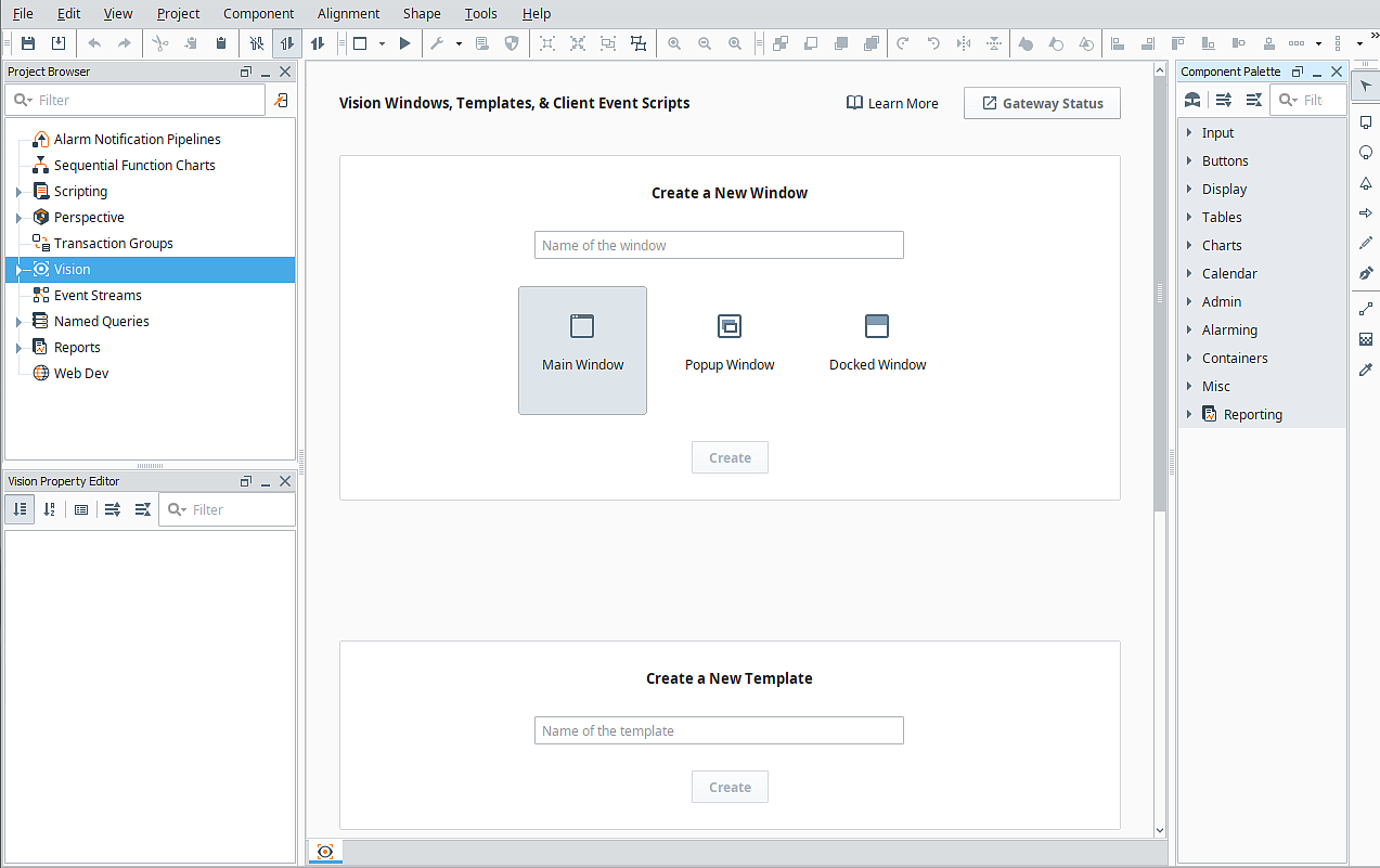

Vision Designer Interface
Vision Designer Workspaceβ
The Vision Designer Interface is where the bulk of the designer's work is done. The Vision Designer Interface provides some built-in functionality to help you get started designing your project whether you are logging into your project for the first time or the 50th time. From the Vision Windows & Templates Welcome tab, you can easily create Main windows, Popup windows, Docked windows and Templates. It even shows you the recently modified windows, so picking up where you left off the last time you logged into your project, is right at your fingertips.
You can also check the Gateway Status from the Designer Interface and see all the Vision Clients that are running along with the Client details and stats.
When looking at a Vision specific element in the Designer, such as a window or template, the Designer is organized with some panels that are specific to the Vision Designer Interface, such as the Property Editor and Component Palette. Other elements of the workspace that are shared between spaces are discussed in the General Designer Interface.
