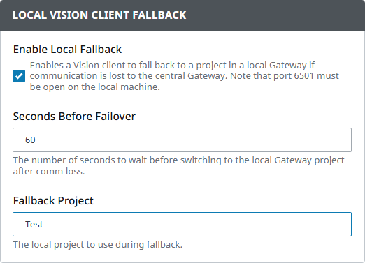

To enable local Vision client fallback, do the following steps:
  1. Go to Platform > System > Gateway Settings in the local Gateway.
  2. Scroll down to the Local Vision Client Fallback section and select Enable Local Fallback.
  3. Enter the name of the Fallback Project.
    note
    The selected project must be published in the local Gateway, and it must have at least one main window.
  4. Optionally, you can change the Seconds Before Failover setting to a value other than 60 seconds. This setting controls the number of seconds to wait before fallback automatically starts. During comm failure, you can also click a button to load the local fallback project immediately.
When local Vision client fallback is enabled, the Client attempts to open port 6501 on the local machine. If the port can be opened successfully, the Client reads fallback settings from the local Gateway and shows a Fallback Project button on the bottom of the Gateway Connection Lost window. You can click this button at any time to load the fallback project, or simply wait for the fallback project to automatically load. You may want to set the local Client to automatically log in to avoid typing in a username and password when the Client loads. This can be set in the Login section of the project's properties.
