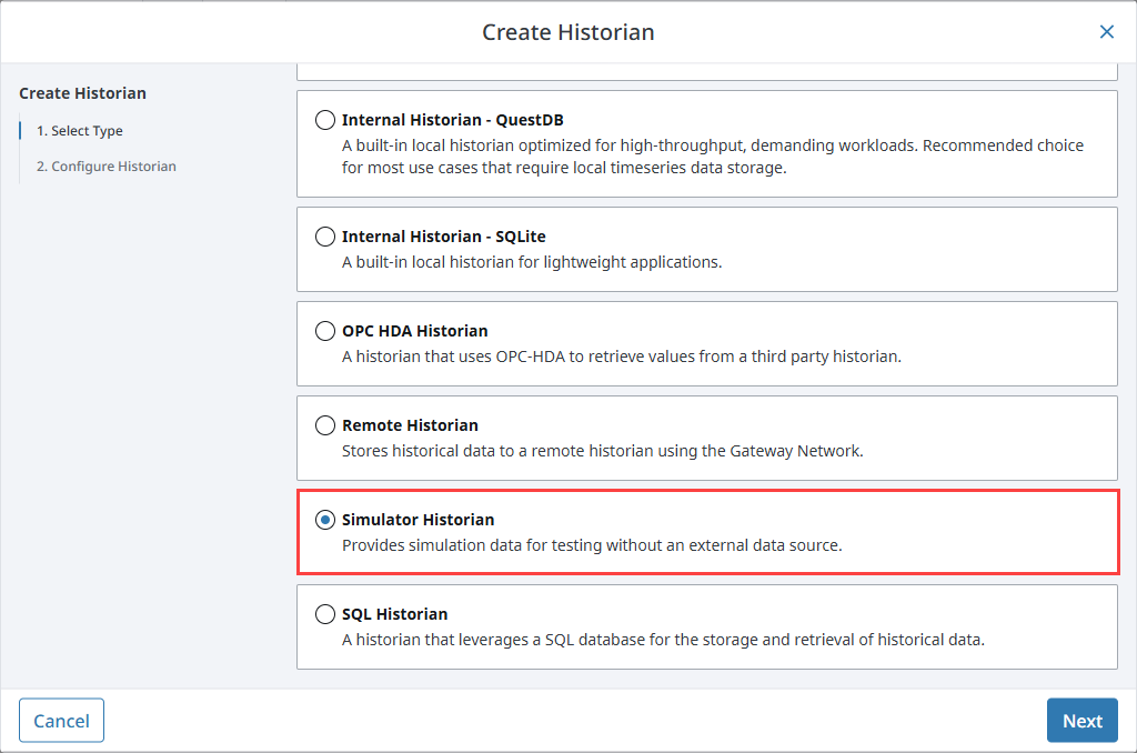

  1. On the Gateway Webpage, navigate to the Services section.
  2. Under the Historians heading in the sidebar, click on Historians.
  3. Click Create Historian.
  4. From the listing of available types, select Simulator Historian, and click Next.
    Configuring a Historian Simulator Provider Step 4

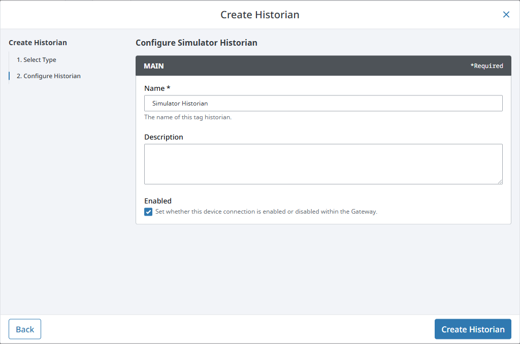

  5. The simulator requires a unique name from other historical providers on the same Gateway, but otherwise does not require any other configuration settings. The bulk of configuration occurs when attempting to request records from the simulator. For now just provide a name, and click the Create Historian button to finish configuring the provider.
    Configuring a Historian Simulator Provider Step 5
You'll be redirected back to the History Provider listings. You're now ready to use the simulator.
