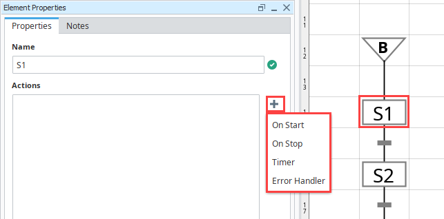

Action Element​
Action steps do the bulk of the work in an SFC. The action step can have any number of scripts associated with it. Each of these scripts is called an action. There are various kinds of actions. The different kinds of actions execute at different times in the step’s lifecycle. During the lifecycle of the step, many actions can run, but only one action is ever allowed to run at a time.
The scripts configured in the action step have access to the chart's scope, as well as a special scope that is private to the step. This scope, called "step scope" is initialized when the step starts and destroyed when the step stops, but retained while the step is running. This is a good place for timer actions to store intermediate results.
Actions are added by clicking the Plus icon for the Actions section in the Element Properties panel and making a selection from the dropdown.
On Start​
This action runs when the step is started. These actions always run to completion before flow can move beyond the step, and before any other scripts on the action step will run. This action will always run at least once.
On Stop​
When flow is ready to move beyond the step, it is told to stop. The step will then wait for any currently executing action, for example, On Start or Timer actions, to finish. Then it will execute its On Stop action, if configured. Only after these actions complete will the chart be allowed to move on. This action will always run at least once.
Timer​
Timer actions run every so often while the action step is running. The timer actions only start running after the On Start action finishes (if there is one). In addition to the timer action's script, it must have a rate, specified in milliseconds. This is the amount of time to wait between running the timer action's script. The clock starts after the On Start action finishes.
It is important to realize that, unlike On Start and On Stop scripts, a timer action can not run at all for an action step. If the step is ready to stop before the timer is ready, it will never run.
Error Handler​
This action will run only if any of the other actions throw an unexpected error. This provides a chance for chart designers to do their own error handling, and gracefully recover from an error. If this script throws an error, the chart will abort, see Chart Concepts for more information.

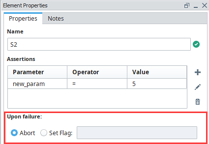

Assertion Element​
Check some conditions before moving on.
The Assertion Step makes one or more conditional assertions and will abort the chart or set a flag based on the result. Each assertion looks at a chart parameter and checks its value. If the value meets the condition, then the assertion passes, and the chart moves on.
Multiple assertions can be added to each Assertion Step, with each requiring a parameter name, an operator, and a value.

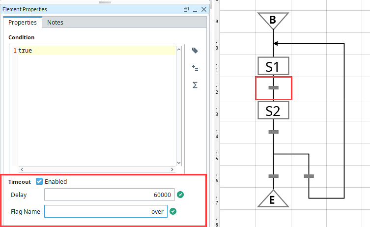

Transition Element​
Transition elements control the flow of the chart.
A transition serves to either block or allow flow, depending on its value. All transitions have a value: true or false, which is determined by an expression. Transitions occupy a one-cell region of the chart, and are represented by a short horizontal bar in the middle of the cell. Read more about how transitions control chart flow on the Chart Flow and Rules page.
In addition to their expression, a transition can also specify a timeout. If enabled, the transition will set a flag after a certain amount of time has passed. This flag is a boolean variable set in chart scope, and can be used to make the expression or another expression close.

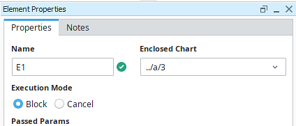

Enclosing Element​
The Enclosing step references another SFC defined on the same Gateway to run another chart inside this one, allowing complex tasks to be spread across several different charts. This is an important tool for SFC design, because it lets the chart designer create reusable blocks of logic encapsulated into charts, which can make chart design more modular.
When talking about enclosing steps, the chart that the enclosing step references is called its enclosed chart, or subchart. The chart that the enclosing step is in is called the parent chart.
You can include a relative path in the Enclosed Chart field.
# A '.' is used to reference a hierarchy object in the same folder
./myChart
# '..' is used to reference the parent folder of the current object
../myChart
In addition, the Enclosed Chart dropdown will now automatically use relative path notation.

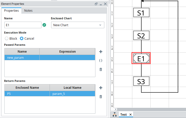

When flow reaches an enclosing step, it starts its enclosed chart. Using the enclosing step's Execution Mode property, the step can be configured to work in one of two very different ways:
  • Execution Mode = Block
    Let the enclosed chart run to completion. This means that the enclosed chart should have an End Step in it, and that flow will not be able to move beyond the enclosing step until the enclosed chart stops by reaching its end step.
  • Execution Mode = Cancel
    Cancel the subchart when the enclosing step is ready to stop. This means that the subchart is canceled when flow is ready to move beyond the enclosing step. Any running steps in the enclosed chart are told to stop, and flow ceases in the enclosed chart.
Parameter Passing​
When invoking a subchart via an enclosing step, you have the opportunity to define how variables are passed and returned between the parent and child chart’s scopes.
The enclosing step can define a list of parameters to be passed into the enclosed chart’s scope. The values for the parameters will be expressions, thus they can be literal values or they can be references to variables in the enclosing chart’s scope.
The enclosing step can also define a list of return values to receive from the enclosed chart. This is a mapping of variable names from the enclosed chart’s scope to variable names in the parent chart’s scope.
Return values can now be mapped to Chart Scoped Variables by using the same syntax that they would in the passed parameters. See Chart Scope and Variables.
