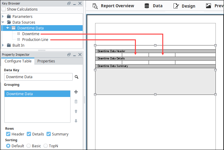

The most important step when configuring a Table is choosing the data source at the beginning. A single report can have many different data sources so the Table's Data Key needs to be assigned an individual data source. The next configuration options include adding header or summary rows and customizing the design.
  1. Go to the Design panel and drag a Table component into the page.
  2. From the Key Browser, expand the Data Sources folder, and drag your data source (i.e., Downtime Data) into the Data Key field of the Configure Table tab of the Property Inspector.
  3. Add Header and Summary rows by marking the checkboxes.
  4. Now, let's configure the data in the Table. With the Table still selected, drag each of the data keys to a cell on the table above the Data Details row: (i.e., Production Line, and Downtime).
  5. Next, let's add column headers by selecting a cell above one of our details cells, and enter the appropriate column header name (i.e., Production Line, and Downtime [Minutes]). You can change the font style, size, and color using the functions on the right side of the Edit Text Tab. Bold the headers using the Bold icon.
  6. Go to the Preview panel to view how your report looks with the data. If it doesn't look how you want, continue making formatting changes as desired.
