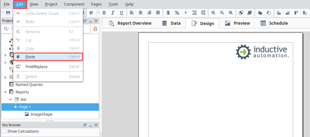

Copy and Paste Images​
You can copy and paste images directly from a webpage, or as a screenshot taken with a capture program, like Snipping Tool or Snagit. The pasted image will be added as an ImageShape component in the report. MacOS also allows copy and pasting directly from the OS filesystem to the report.
If you have multiple images you'd like to add, you can multi-select a group of images. When selecting multiple files, only accepted image file formats will be pasted, with any non-image files logging an "unsupported file" message instead. Images can be copy and pasted using the keyboard shortcuts Ctrl + C to copy and Ctrl + V to paste. Additionally, once an image or group of images are copied, you can also use the Edit dropdown on the top navigation bar of the Designer and select Paste. Make sure to select the report on the Design tab before pasting.
