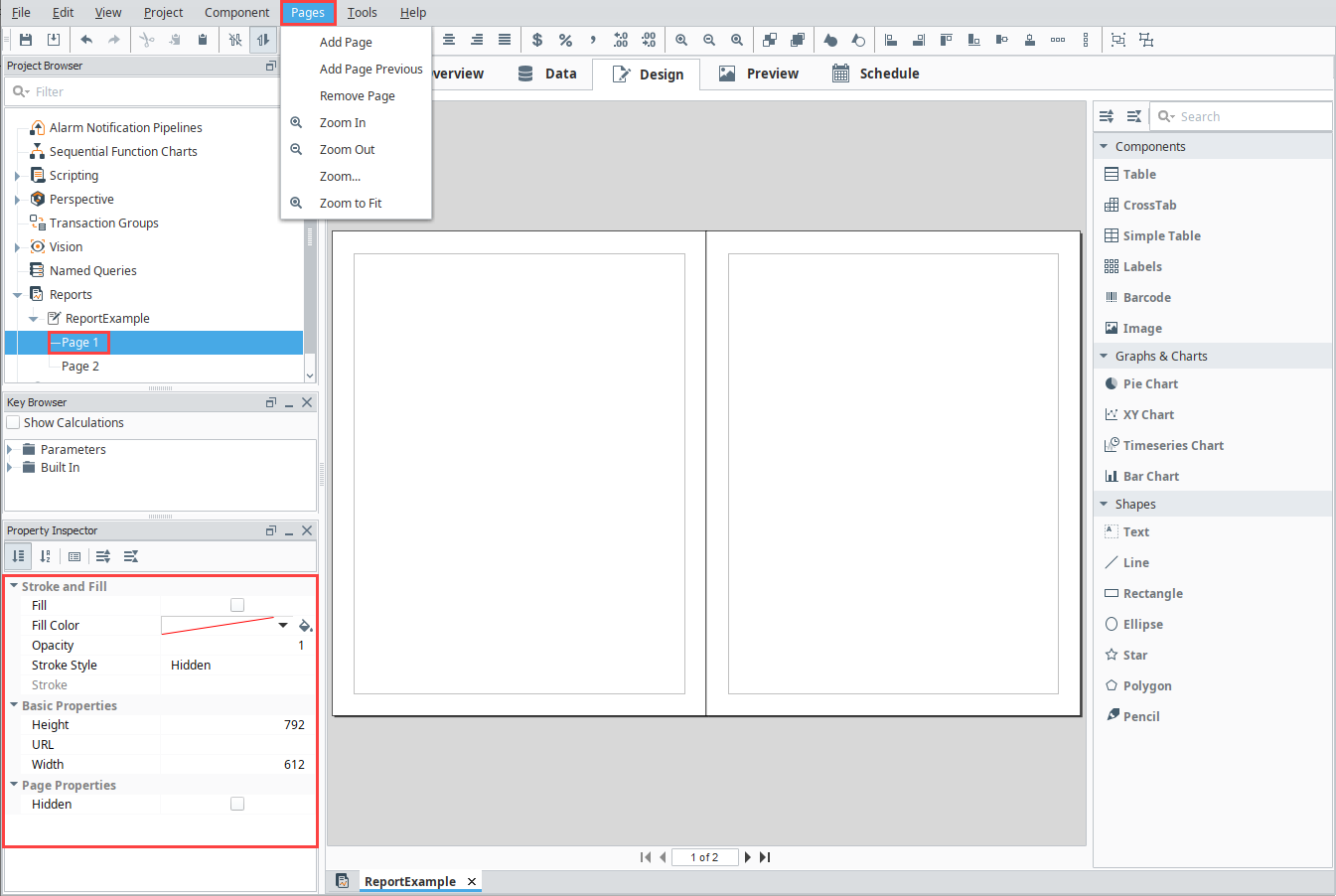

Report Designer Interface​
The Report Workspace's Design tab lets you design reports with the same intuitive feel, familiar layout, and drawing tools that you get when designing windows in Ignition. Just like designing Vision windows, you can design reports using the same familiar drag-and-drop method and choose from a library of graphs, charts, tables, and images.
Looking at the screenshot of the Report Designer, you'll notice that an open Report Resource in the Project Browser can be expanded to provide information at a glance. This tree lets you visualize the relationship and hierarchy of Report Design elements on the page. Find an element in the tree by selecting items on the Design Panel, or find an element on the page by selecting it from the tree. As you do so, you'll notice that the bottom left of the default Report Designer will change to provide configure panels and/or property tables depending on the selected item.
Just below the Project Browser is the Key Browser which provides the Data Keys we use to reference data in our report. The Key Browser is home to all your Data Sources, Parameters, as well as a number of built-in calculation keys to speed you through the report design process. When you configure a data source and switch to the Design tab, a sample of all your queries is run on the Gateway to get information about the structure of your data. Columns in your data are represented as children in the Key Browser tree.
The right side of the panel is where the component palette lives, providing a number of powerful components, charts, and shapes which are used to build the layout and visualization of your report.

  • Report Object: Allows you to set the report properties for paper size, dimensions, orientation, margins, and much more.
  • Page Object: Allows you to add and remove pages in your report, as well as configure properties to add creativity and functionality to your reports. Page Objects can be accessed in the top navigation bar by selecting Pages, and in the Property Inspector when a report page is selected.
