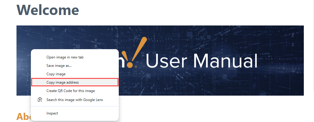

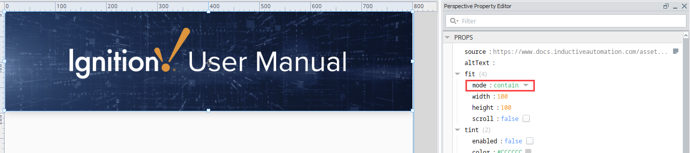

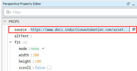

Use an External Web Address​
Images can also be added to the Image component by pasting a copied image address from a web browser into the source property.
  1. Right-click an image and select Copy image path.
  2. In the Designer, drag an Image component onto a view.
  3. Paste the image address into the source field in the Property Editor.
  4. Adjust the corner nodes to display the full image or select a desired fit from the mode dropdown.

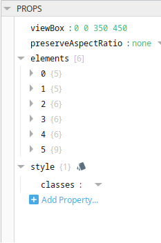

Convert SVG-based Components to Drawings​
Right-clicking an SVG-based Perspective component will show a Convert to Drawing option. Converting the component to a drawing transforms the component's properties. For example, the Cylindrical Tank component props list changes to include properties like viewBox, preserveAspectRatio, and elements.
Component ExamplePropertiesProperty Editor Image
Cylindrical Tank as a Component
  • value
  • capacity
  • liquidColor
  • tankColor
  • liquidOpacity
  • liquidWarningColor
  • tankWarningColor
  • warningThreshold
  • strokeWidth
  • valueDisplay
    • enabled
    • style
  • style
Cylindrical Tank as a Drawing
  • viewBox
  • preserveAspectRatio
  • elements
    • 1
    • 2
    • 3
    • 4
    • 5
  • style
