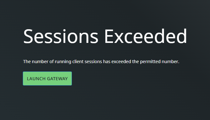

Note that if you are using Edge Panel, the maximum number of concurrent Sessions you can have is two. Attempting to open a third will cause a message to appear saying that the number of running Sessions has been exceeded.
Edge Number of Sessions Exceeded

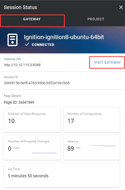

Session Status Popup​
In the middle of the app bar at the bottom of the window, the current Gateway name is displayed. Click on this for additional information. The pop-up screen shows the current user and connected Gateway. If no user is signed in, a Sign In button is displayed in the upper right corner.
Click on the right arrow, or anywhere on the Gateway name to open the Session Status popup.
The Session Status popup has two tabs: Gateway and Project. Under the Gateway tab, you can see the connection status, Gateway URL, Session ID, and Page Details. The Page Details section includes the Page ID and data for the number of view resources, components, and property changes, as well as the Latency regarding the time taken for the Gateway to receive a response from a request and Up Time since the page was last refreshed or loaded. The Visit Gateway button is a shortcut to the Gateway Homepage.
Under the Project tab, you see the name of the project, the last modified date for the project, and whether the project is up to date.
