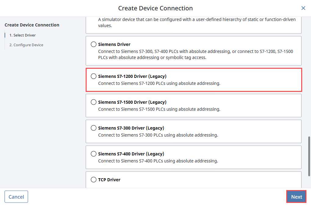

  1. Go to the Connections section of the Gateway Webpage.
  2. Select Devices > Connections.
  3. On the Devices page, click on Create Device Connection +.
  4. All four of the available driver options are shown on the Select Driver form. For this example we will select Siemens S7-1200 Driver.
    • Siemens S7-1500 Driver: Connects to Siemens S7-1500 PLCs over Ethernet.
    • Siemens S7-1200 Driver: Connects to Siemens S7-1200 PLCs over Ethernet.
    • Siemens S7-300 Driver: Connects to Siemens S7-300 PLCs over Ethernet.
    • Siemens S7-400 Driver: Connects to siemens S7-400 PLCs over Ethernet.
  5. Click Next.
  6. On the New Device page, leave all the default values and type in the following fields:
    • Name: S71200
    • Hostname: type the IP address, for example 10.20.4.71.
  7. You can check the box for Show Advanced + to see the additional settings, but you can keep all the defaults.
  8. Click Create Device Connection. The Devices page is displayed showing the Siemens device is successfully created and added to Ignition. The Status will show as Disconnected and then Connected.
