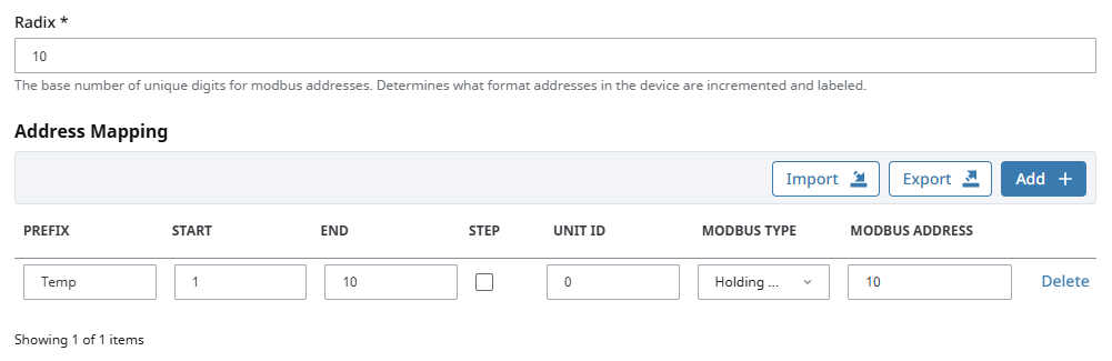

Simple Mapping Demonstration
Temperature readings are being stored in 10 16-bit addresses: 40,010 - 40,019. There is a single Modbus device at the IP address (unit ID 0), and the addresses are decimal. The mapped addresses should appear in the Connected Devices window as "Temp1", "Temp2", and so-on. The following configuration would be used:
  • Prefix: Temp
  • Start: 1
  • End: 10
  • Step: False
  • Unit ID: 0
  • Modbus Type: Holding Register (Int16)
  • Modbus Address: 10
note
Address 40,010 (HR10) uses Modbus Address 10 as a starting point and not 40,010. The leading 4 is automatically entered for you when you select Holding Register from the dropdown. The same is true for all other types of tags: Inputs are 30,000, Discrete are 10,000, etc.
The above configuration results in the items Temp1 through Temp10 appearing in the Connected Devices window.

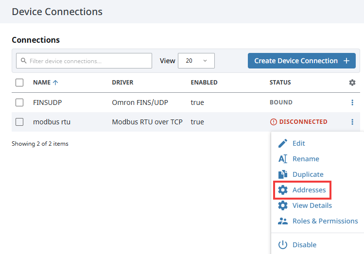

  1. Go to the Connections section of the Gateway Webpage.
  2. Select Devices > Connections.
  3. Click on the three dots menu and select Addresses to the right of your Modbus device.

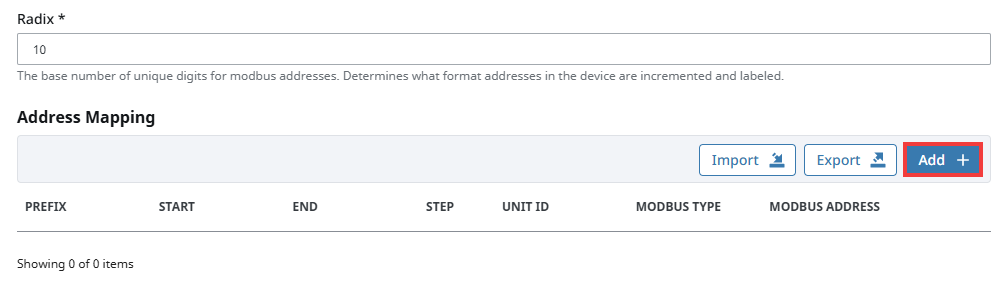

  4. Click on Add.
    Specify Address Mapping Step 4

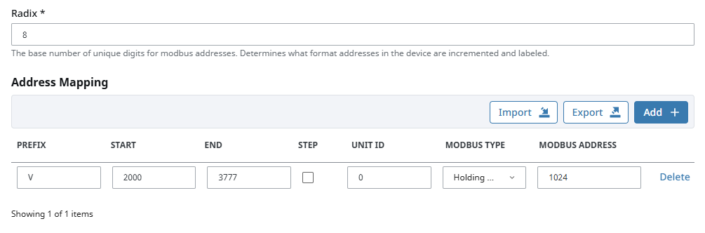

  5. Enter the mapping as follows:
    • Prefix: V
    • Start: 2000
    • End: 3777
    • Modbus Address: 1024
    • Radix: 8 (8 causes the address to be in octal, also known as base 8)
    Specify Address Mapping Step 5
    These settings map the Modbus address range V2000 to V3777 in octal to Modbus Holding Register addresses 1024 to 2048.

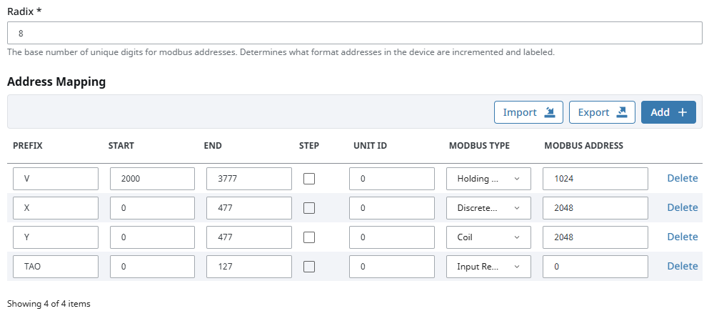

Here is an example of mapping for all of the Modbus DL240 addressing.
PrefixStartEndUnit IDModbus TypeModbus Address
V200037770Holding Register (Int16)1024
X20004770Discrete Input2028
Y04770Coil2048
TAO01270Input Register (BCD16)0
Specify Address Mapping Example

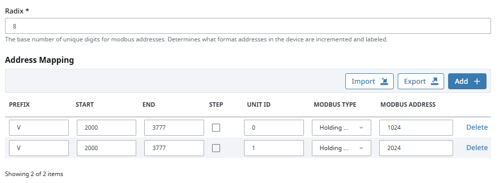

Address Mapping Multiple Devices
It is not recommended to communicate to multiple Modbus devices through a Modbus Gateway where Gateway has the same address. Therefore, do not add multiple Modbus devices with the same IP address.
Only add one Modbus device to the Ignition OPC UA Server device list for Gateway and specify the different unit IDs in the address mapping. The unit ID is specified for each entry in the address mapping for the Modbus device. Notice in the example below, the Prefix, Start, End, Modbus Type and Modbus Address can be the same for two entries provided that the Unit IDs are different.
V200037771Holding Register (Int16)2024
Now when browsing the Modbus device, the unit ID will show as a folder and the OPC tag path includes the unit ID. This only happens when more than one unit ID is specified in the address mapping otherwise the unit ID is eliminated.

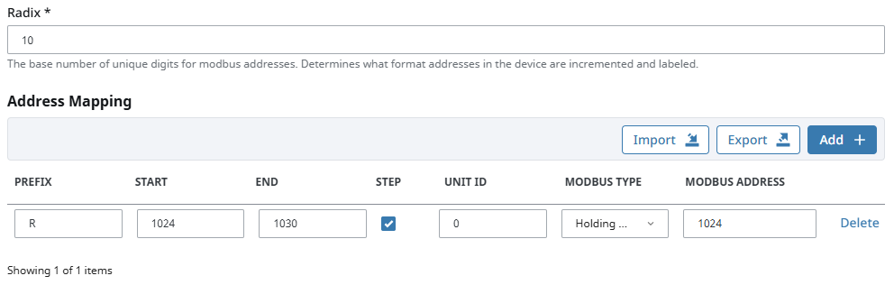

Mapping Float Point Addresses
The Modbus address mapping below shows how to map float point addresses starting at 1024 and ending at 1030. With the box in the Step column checked, the addresses on the Ignition side will index by 2. In this case, R1024, R1026, R1028 and R1030 will be created.
Because Modbus Type of Holding Register (Float) is selected, the driver will read two consecutive 16-bit words and convert it to a floating point value. It also indexes the Modbus Address by 2 for each entry. In this case, R1024 reads from Modbus addresses 1024 and 1025 and converts them into a floating point value. When writing, the reverse of converting a floating point value into two 16-bits words is done before sending them to the device.
Mapping Float Point Addresses Holding Register
The following shows what is displayed in the Connected Devices window. Notice that the numbering is indexed by two and that it matches the Modbus address. With some devices, this allows the addresses displaying in the Connected Devices window to match the addresses in the device.
