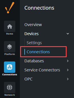

  1. On the Gateway webpage, go to Connections > Devices > Connections.
    Connect to Remote BACnet Device Step 1

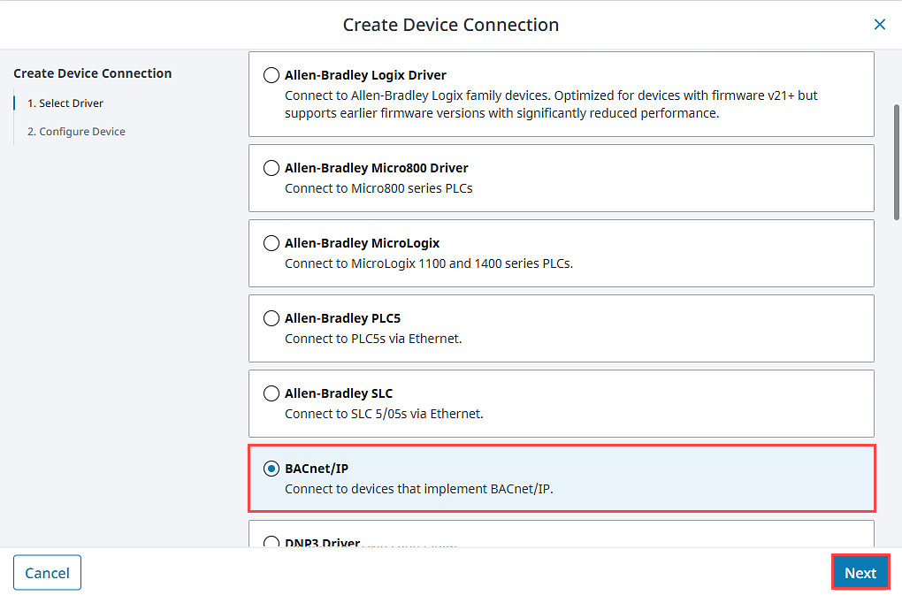

  2. Click on Create Device Connection.
  3. Select BACnet/IP and click Next.
    Connect to Remote BACnet Device Step 3

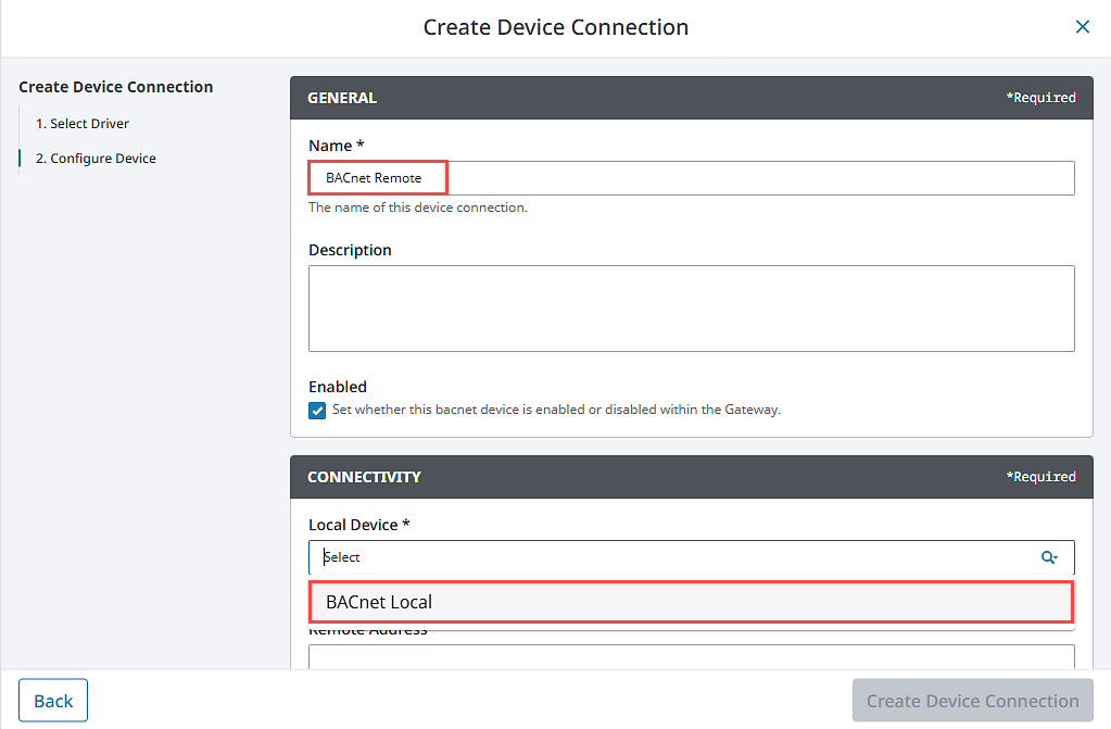

  4. Fill in the following fields:
    • Name: BACnet Remote
    • Local Device: Select the local device from the dropdown. If no local devices are shown, you'll need to set one up first.
    • Remote Address: Enter the IP address, for example 10.10.###.##
    • Remote Device Number: The instance number of the remote device you're setting up.
  5. Leave the default values in the remaining fields.
  6. Click Create Device Connection.
The Device Connections page is displayed, showing the BACnet/IP device is successfully created and added to Ignition.
