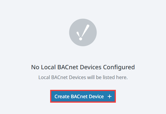

  2. Click on Create BACnet Device.
    Configure Local BACnet Step 2
