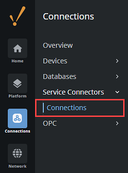

  1. Navigate to Connections > Service Connectors > Connections on the Gateway, and click Create Connection +.

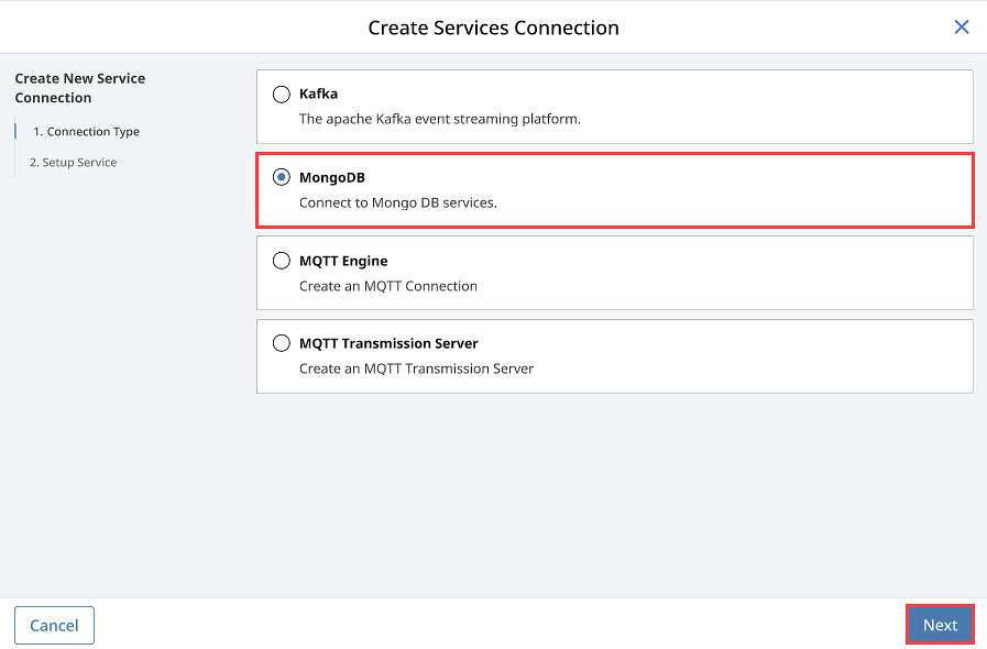

  2. Select MongoDB and click Next.

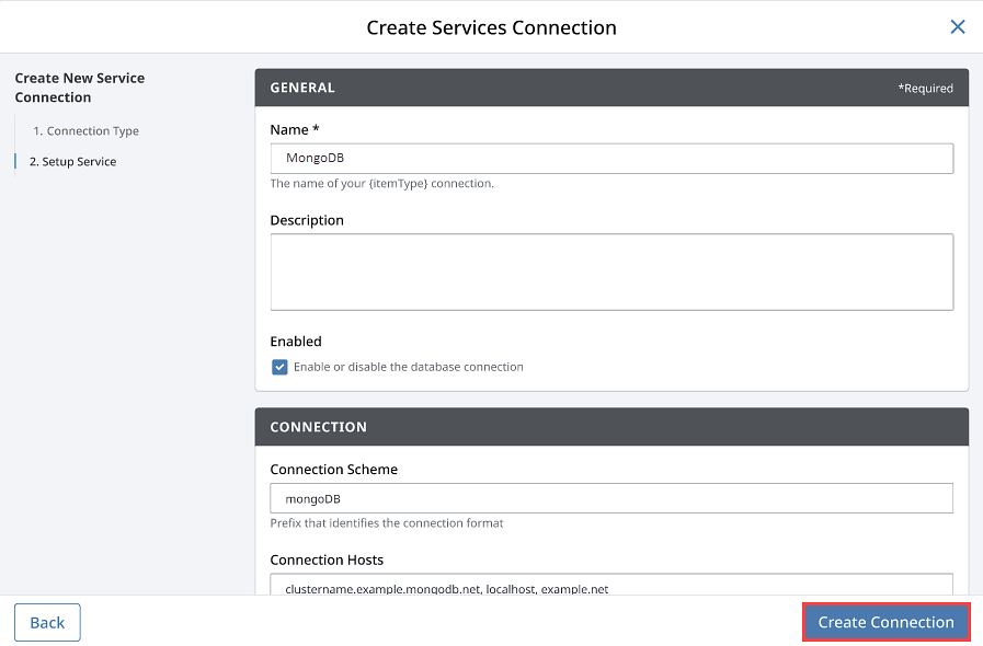

  3. Fill out the Gateway fields with the appropriate information from your connection URL and the database name, then click Create Connection.
    Connect Ignition to MongoDB Step 2
Your MongoDB connection is now created. It may take a few seconds for your connection to update to a Valid status.
