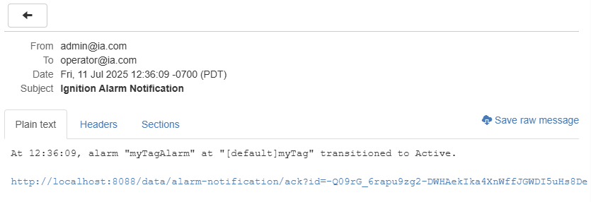

  1. Open the the alarm notification email message, and click the link.
    Using Email Alarm Acknowledgement Step 1

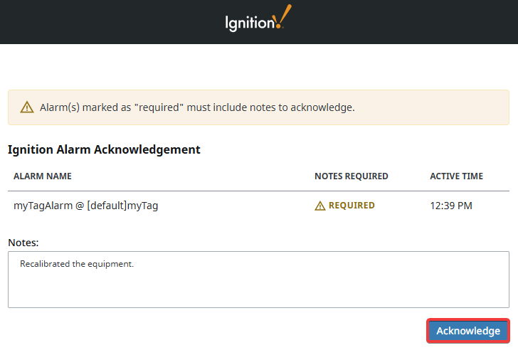

  2. A new window opens describing the alarm. This example shows one email for one alarm.
  3. If notes are required as in the following example, enter notes about the alarm.
  4. Click the Acknowledge button.
    Using Email Alarm Acknowledgement Step 4

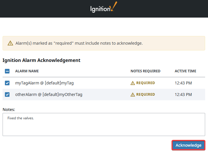

  5. If notification consolidation is configured, you can limit the number of email notifications that will be sent, thus, consolidating multiple alarms into one email for operators to acknowledge.
    Using Email Alarm Acknowledgement Step 5
