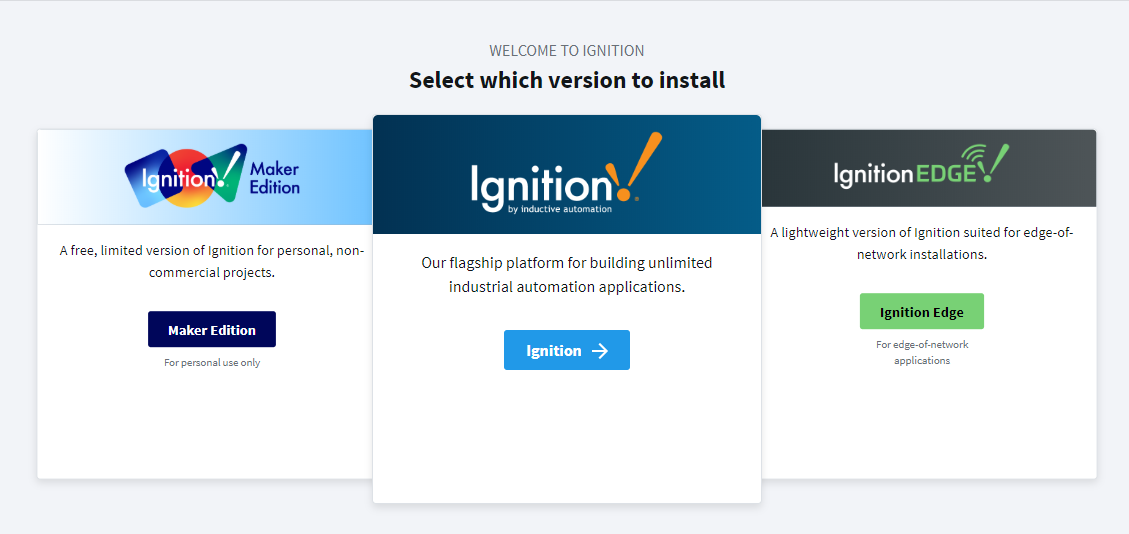

  7. You will be presented with three versions of Ignition to choose from. In this example, we will use the Standard Edition.
    Downloading and Installing Ignition Step 7
    note
    Ignition Maker Edition is for personal, non-commercial use. See the Ignition Maker Edition page for more details.
    Ignition Edge is a light version of Ignition intended for on field and edge-of-network use. See the Ignition Edge page for more details.

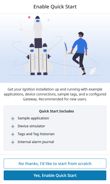

  12. Once the Gateway finishes commissioning, you will be prompted to enable Quick Start. Quick Start contains different preconfigured resources and connections. For this example, we will select Yes, Enable Quick Start.
    Downloading and Installing Ignition Step 12 Quick Start
    note
    You cannot enable Quick Start past this point if you selected the option to start from scratch. If you decide that you would rather like to have the preconfigured resources Quick Start provides, restore the Gateway backup located here.

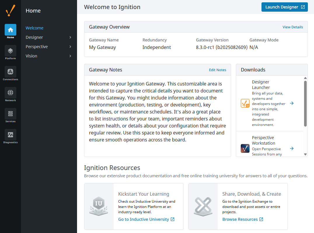

  15. Once the Quick Start process is complete, your Gateway will be ready to use. If you are accessing the Gateway on the machine it is installed on, you can get to the Gateway by going to http://localhost:8088 and signing in with the credentials created in step nine.

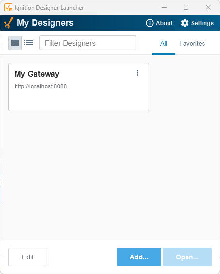

Downloading and Installing the Designer Launcher​

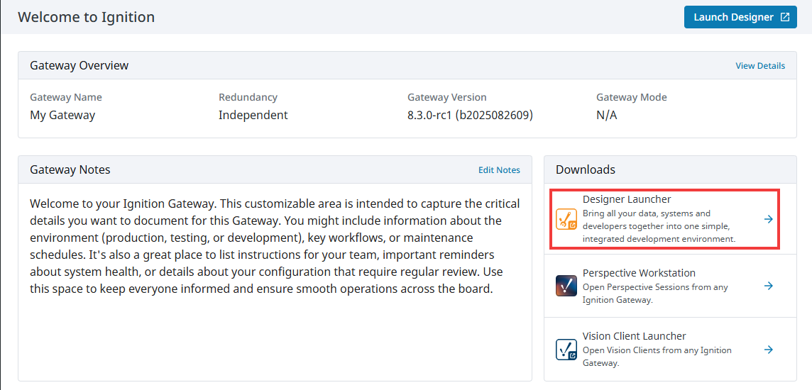

To begin designing a project, you will first need the Designer Launcher, which is found on the Gateway Webpage.
The Designer Launcher is simply a location to consolidate the different Gateways you can connect to and create projects for within your network, including remote Gateways. It is convenient to have if you want to connect to multiple Gateways.
note
Alternatively, you can use the Launch Designer button on the top right of the Gateway Webpage to launch the Designer directly. Go to step x if you want to skip using the Designer Launcher.

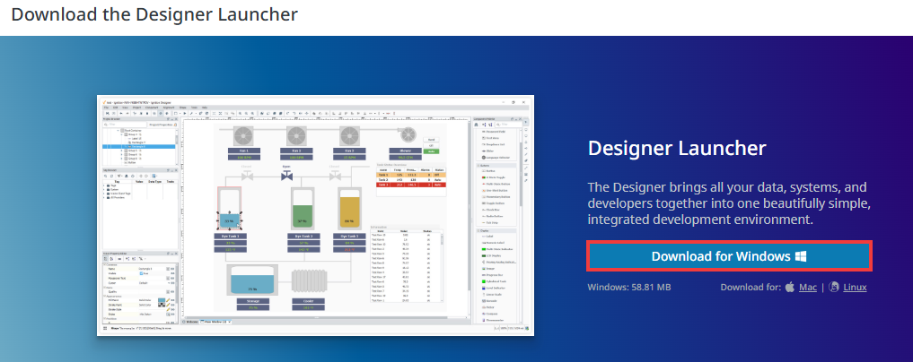

  1. On the Gateway Webpage, click on Designer Launcher in the Downloads category. This will bring you to the Download page for the Designer.
    Designer Launcher Step 1
  2. Click the Download button to download the launcher. The Gateway will automatically detect which operating system to download the launcher for.
    Designer Launcher Step 2

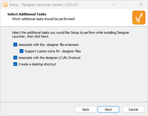

  3. Open the downloaded file. You may be prompted to install for either all users or only the current user, depending on your administrative privileges. We will install the Designer Launcher for all users.
  4. The Designer Launcher Setup Wizard will open and display the file location to install the launcher in. We will use the default directory. Once you have specified a location, click Next.
  5. You will be prompted to select any additional tasks to perform, such as associating the .designer file extension or creating a desktop shortcut. We will leave the default settings here and click Next.
    Designer Launcher Step 5
  6. The Ready to Install page will provide a summary of your choices. If you are satisfied, click Install.
  7. Once the Designer Launcher finishes installing, click Finish. The setup wizard will close and open the newly installed launcher, and your Gateway should be selectable in the Designer Launcher.
    Designer Launcher Step 7

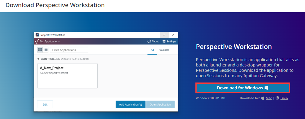

Similar to the Designer Launcher, Perspective Workstation will allow you to quickly launch any Perspective-based project regardless of whether the Perspective project is locally hosted or on a remote system. This will allow us to open and test our Perspective project when it is done as an operator would.

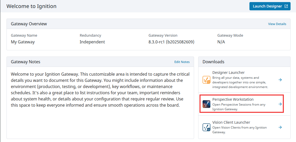

  1. On the Gateway Webpage, click on Perspective Workstation in the Downloads category. This will bring you to the Download page for Perspective Workstation.
    Perspective Workstation Step 1
    Perspective Workstation Step 2

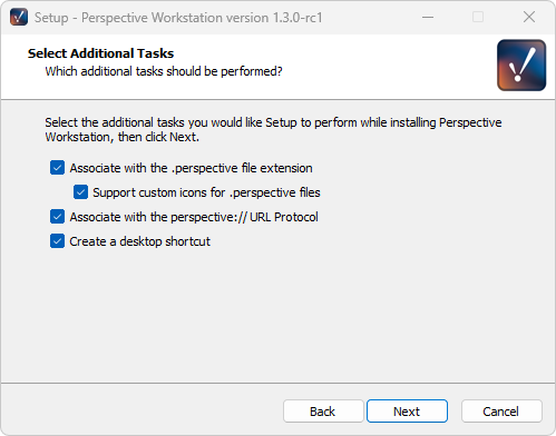

  5. You will be prompted to select any aditional tasks to perform, such as associating the .perspective file extension or creating a desktop shortcut. We will leave the default settings here and click Next.

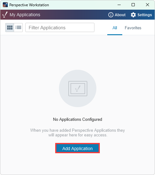

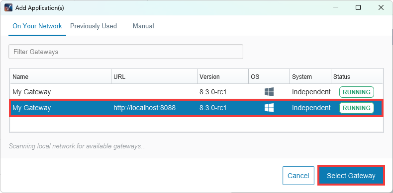

  8. You may need to add your Gateway if you are receiving a No Applications Configured message. To do this, click on Add Aplication in Perspective Workstation.
    Perspective Workstation Step 8
  9. The Add Application(s) window will appear and display all the available Gateways to select. Since our project is going to be on our locally hosted Gateway, we can select the Gateway located at http://localhost:8088, then click Select Gateway.
    Perspective Workstation Step 9

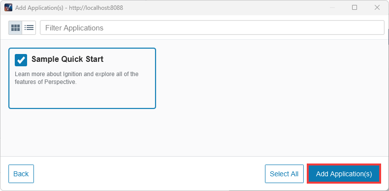

  10. You will be prompted to select which projects to add. Since we enabled Quick Start when first commissioning our Gateway, we already have a project called Sample Quick Start, which we will add by clicking Add Application(s).
    Perspective Workstation Step 10
Your Perspective project should now be launchable within Perspective Workstation.
