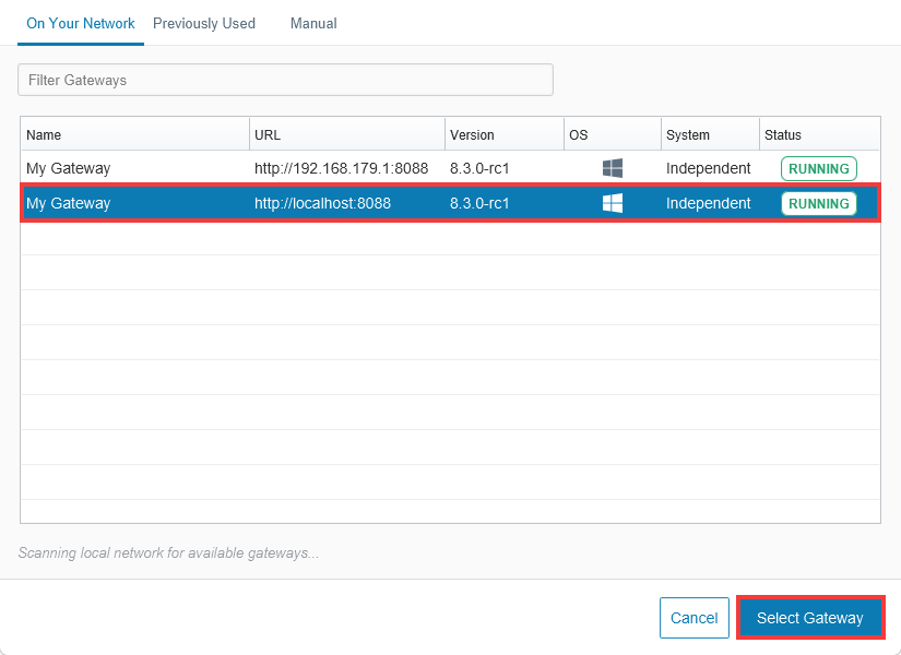

To begin working on a project, we will first need to create one.
  1. In the Designer Launcher, select the Gateway to create the project on and then click Open.... We will be using our locally installed Gateway in this guide.
  2. The Designer will initialize and then prompt you for login credentials. Use the credentials you set up when first commissioning the Gateway.

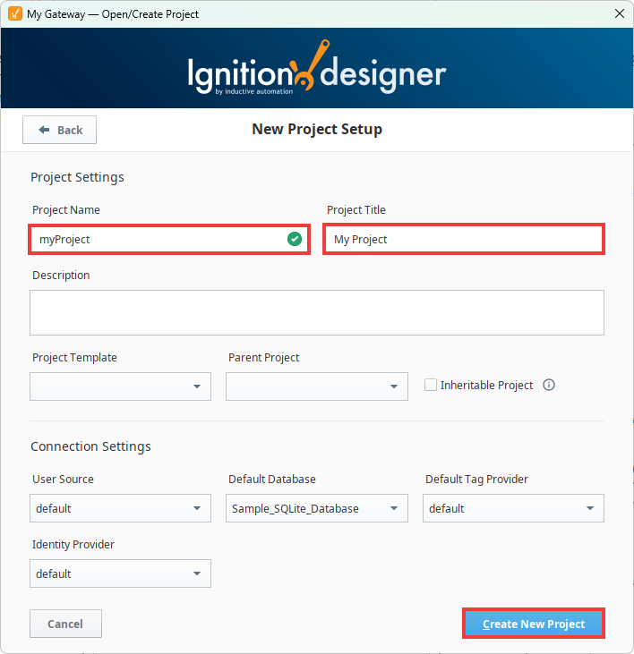

  4. Give your project a name and title, then click Create New Project. Your new project will initialize and open the Designer. We will call our project myProject and give it a title of My Project.
    Creating the Project Step 4
Your project should now be ready to build in.

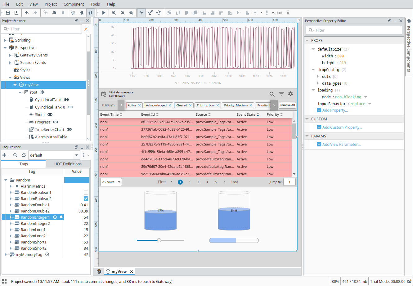

Preparing Perspective Components​

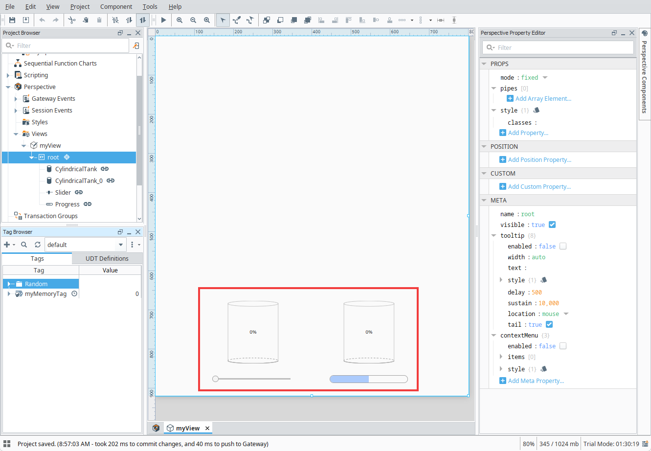

Let's start putting components into our view. Components are the main features an operator interacts with within a project and includes things like charts, input components, and display components.
  1. Begin by dragging two Cylindrical Tanks, a Slider, and a Progress Bar from the Perspective Component Palette onto your workspace and orient them on the bottom as shown in the image below. We will bind these together using tag data in a later section.
    Preparing Perspective Components Step 1
    tip
    You can use the Designer's red dotted guiding lines to help line up components so that they are on the same axis.

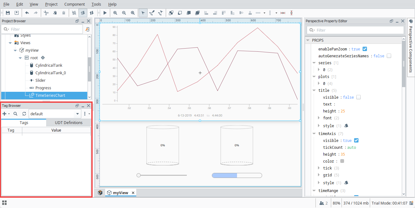

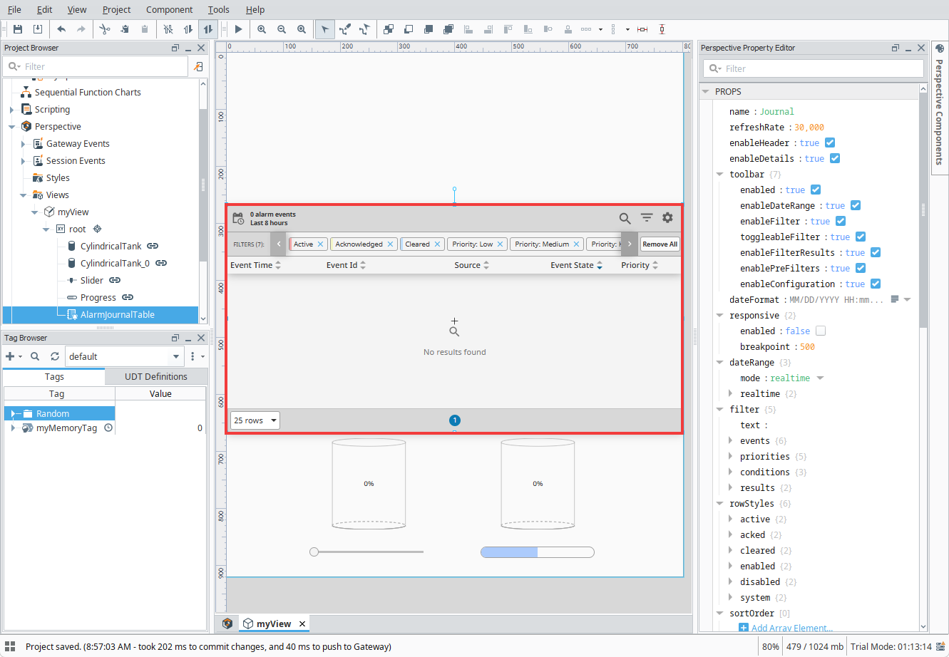

  2. Next, drag an Alarm Journal Table to the space above the components from the previous step. We will use this table to display our alarm history in a later section.
    Preparing Perspective Components Step 2
  3. Drag a Time Series Chart from the Component Palette onto the top of your workspace. Use the handles to resize the component so that it sits flush with the top of the view and the top of the Alarm Journal Table. We will use this to visualize your tag's historical data in a later section.
    Preparing Perspective Components Step 3
  4. Save your project.
Your components are now ready to have tags bound to them to display data.

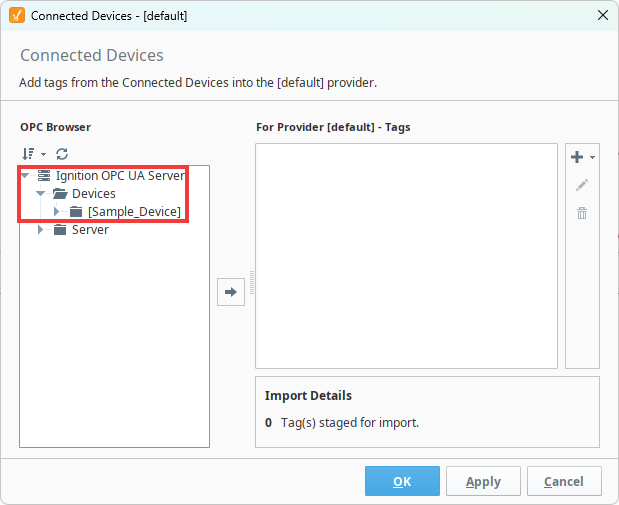

  2. Click on the Add Add Icon icon, then select Browse Devices. This will bring up the Connected Devices popup.
    Adding Tags from a Device Step 2
  3. The Ignition OPC UA Server will populate under the OPC Browser column. Go to the Device Simulator by expanding Ignition OPC UA Server > Devices. The preconfigured simulator will be called [Sample_Device].
    Adding Tags from a Device Step 3

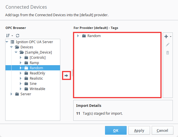

  4. Expand the [Sample_Device] folder and click on the Random folder. This folder contains all the tags we need for this basic project.
    note
    You can choose to import all the tags from your device. However, since we don't need the other tags on the Device Simulator, we will just import the Random folder.
  5. With the Random folder selected, click on the Add Add OPC Tag Icon icon in the middle of the Connected Devices popup. This will add the Random folder and its tags to the staging area for import.
    Adding Tags from a Device Step 4
    tip
    You can add tags to a different Tag Provider than the default provider by changing the provider in the Tag Browser before importing any tags.
  6. Click OK to add the Random folder.

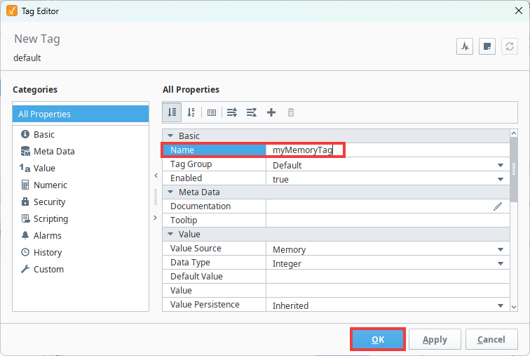

Besides pulling tags from a device over OPC UA, you can also create your own tag. This section will demonstrate how to create a Memory tag, which will be used in a later section.
  1. In the Tag Browser, click on the Add Add Icon icon, then select New Standard Tag > Memory Tag. This will open the Tag Editor.
    Creating Tags Within the Tag Browser Step 1
  2. Give your tag a name. We will name our tag myMemoryTag. Since we are making a simple binding to a component, we do not need to configure any other properties at this time. After you have named your tag, click OK.
    Creating Tags Within the Tag Browser Step 2
Your Memory tag is now created and ready to use.

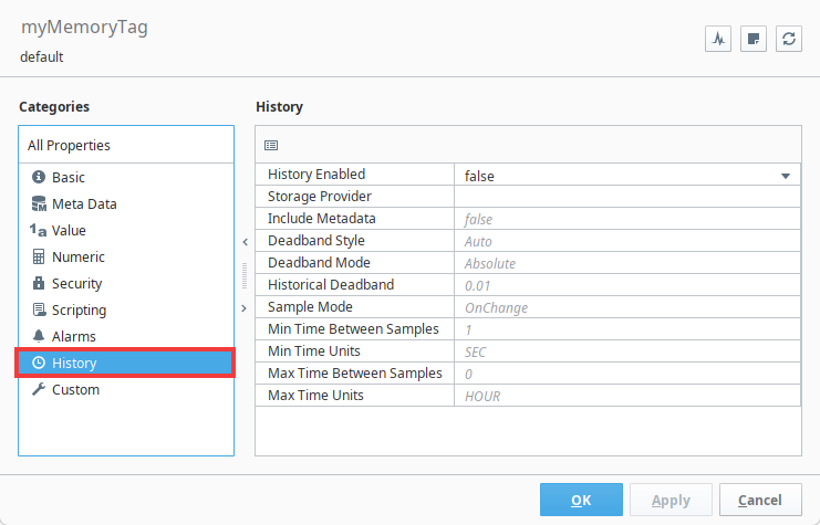

Setting Up Tag History​
Now that your tags have been created, we can set up history on the tags we will be using. This lets us record historical tag values and display them to see trends and past data.
Storing historical data typically requires setting up a database connection and a history provider.
We will be storing history to the SQLite SQL Historian resource configured by the Gateway's Quick Start when first commissioning the Gateway.
caution
Even though we are using the SQLite database connection for this example, it is NOT recommended to store history using SQLite. A dedicated external database, such as Microsoft SQL Server or MySQL, should be used instead, as they will handle the potential amount of writes and reads needed for development and production data much better.
  1. In the Tag Browser, right-click on the Memory tag you created, then select Edit tag(s). This will open the Tag Editor.
  2. Click on the History category of the Categories section.
    Setting Up Tag History Step 2
  3. Under the History Enabled property, change the field from false to true. This will enable the rest of the history fields.
  4. Under the Storage Provider property, change the field to the history provider you set up previously. In this example, we will be using the Sample_SQLite_Database configured from Quick Start.
  5. Click OK to save these settings.

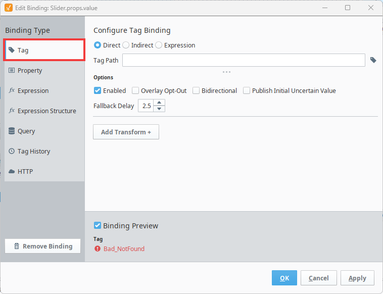

  2. Go to the value property. You'll notice that hovering over this property will cause a light gray Add Binding Add Binding Icon icon to appear. Click on the icon to open the Edit Binding window.
  3. Click on the Tag Binding Type. This will open the Configure Tag Binding section.
    Binding Tags to Components Step 3

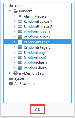

  4. Click on the Browse Tags Browse Tags Icon icon to the right of the Tag Path field. This will open a navigatable tree.
  5. Within the tree, expand the Tags folder and select the Memory tag you created previously, then click OK. This will populate the Tag Path field with your Memory tag.
    Binding Tags to Components Step 5
    note
    If you do not have a value for your Memory tag by the end of the Slider Tag binding process, the Tag binding will still work, but an error will be shown.
  6. Toggle the Bidirectional property to enable it. This will allow our Slider to control our Memory tag.
  7. Click OK.

  5. In the tag tree, navigate to Tags > Random, select RandomInteger1, and press OK.

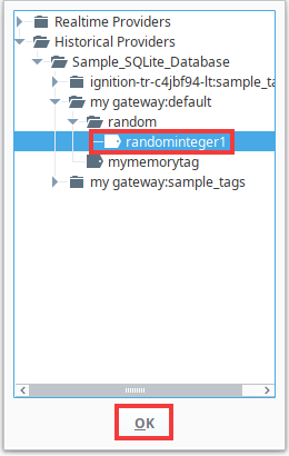

Displaying Tag History​
Now that we have our tags' live values displayed in our project, let's focus on displaying our tags' history. To do this, we will bind our historical data to the Time Series Chart we created in the Preparing Perspective Components section.
  1. Click on The Time Series Chart to bring up its properties in the Perspective Property Editor. The property we will want to utilize is series.
  2. Expand the series property, and then the 0 property if they aren't expanded already. You'll notice that unlike the previous component properties, there are additional subproperties beneath series. This is because unlike value, series is an array that contains multiple sources of data.
  3. Click on the Add Binding Add Binding Icon icon for the Chart's series > 0 > data property.
  4. Select the Tag History Binding Type.
  5. Change the Time Range property to Historical.
    Displaying Tag History Step 5
  6. Click on the Browse Tags Browse Tags Icon icon.
  7. In the tag tree, navigate to Historical Providers > Sample_SQLite_Database > myGateway:default. Select your Memory tag, and then press OK.
    Displaying Tag History Step 7
  8. Press OK on the Edit Binding window.
Your Memory tag's history should now be displayed on the Time Series Chart. We'll now add the historical data from RandomInteger1.

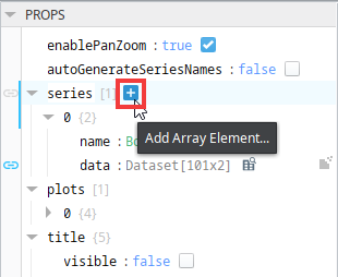

  2. Since series is an array, we can add additional properties to it. Hovering over the series property will bring up an Add Array Element... Add Array Element Icon icon. Click on this icon to add an element to the array. This will add a new 1 property under series.
    Displaying Tag History Step 2b
  3. Click on the Add Binding Add Binding Icon icon for the Chart's series > 1 > data property.
  7. In the tag tree, navigate to Historical Providers > Sample_SQLite_Database > myGateway:default > random. Select RandomInteger1, and then press OK.
    Displaying Tag History Step 7b
Your RandomInteger1 OPC tag should now also be displayed on the Time Series Chart.

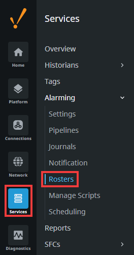

Creating an On-Call Roster​
We'll first set up an On-Call Roster on the Gateway. If your Gateway is installed locally, you can access your Gateway at http://localhost:8088/.
  1. Navigate to Services > Alarming > Rosters.
    Creating an On-Call Roster Step 2
  2. Click on Create Alarm Roster +.
  3. Give your roster a name, then click Create Alarm Roster. We will name ours myRoster.

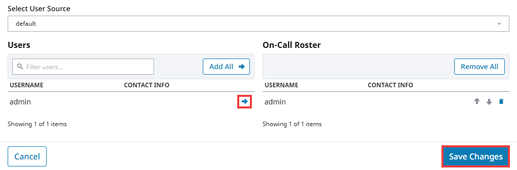

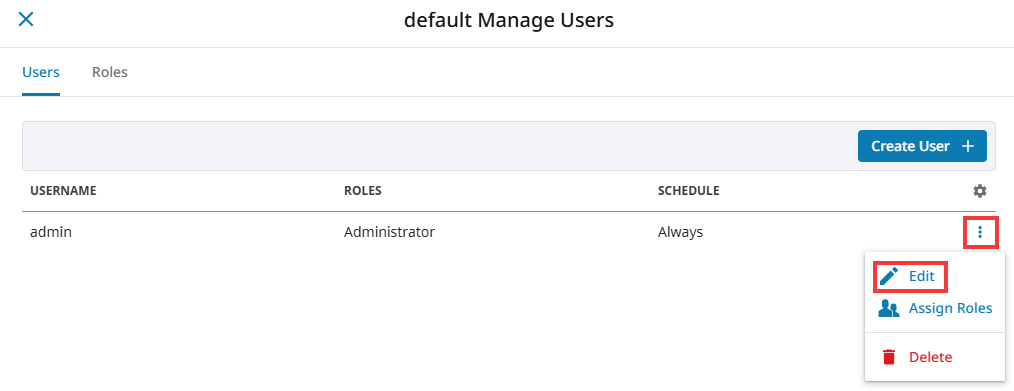

  4. Click on the three dots menu on the right of the new roster, and click Manage Users.
    Creating an On-Call Roster Step 5
  5. Select default from the Select User Source dropdown. The default User Source contains the admin user you created when first commissioning the Gateway.
  6. With the admin user displayed, click on the Add to Roster Add to Roster Icon icon and then Save Changes on the bottom right.
    Creating an On-Call Roster Step 7
Your admin user is now part of the roster.

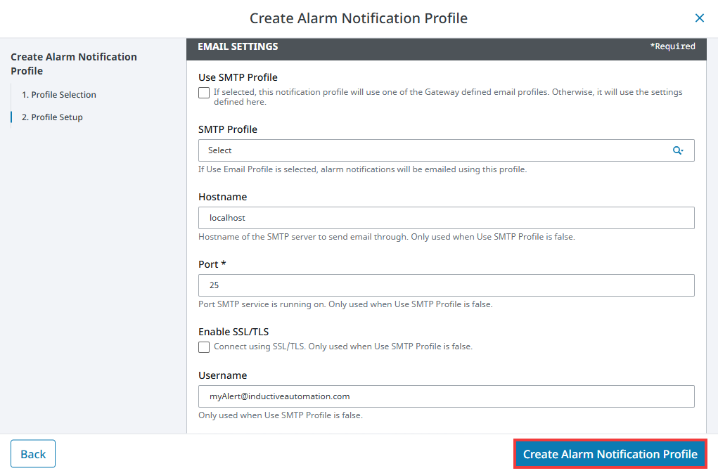

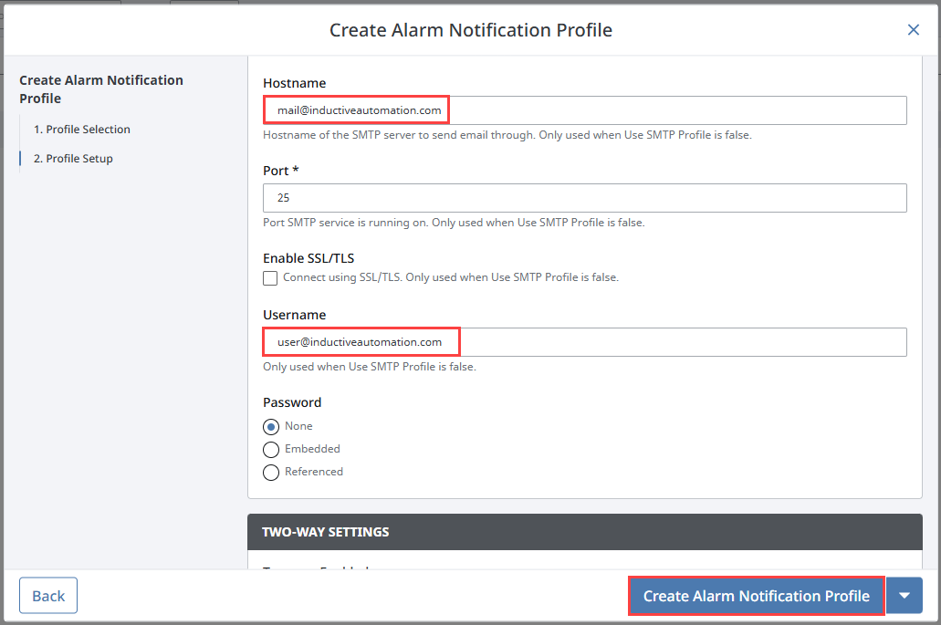

Creating an Alarm Notification Profile​
Next, we'll set up an Email Notification Profile for our Notification Profile. All Notification Profile options and their settings are described on the Notification Profile Types page.
  1. Navigate to Services > Alarming > Notification.
  2. Click on Create Profile +.
  3. Select the Email Notification option. Click Next.
  4. Fill in the required fields. Take note of the Username field, as you will need this value later. Once you have filled out the form, click Create Alarm Notification Profile. In this example, we used the following values:
    Creating an Alarm Notification Profile Step 4

  1. Navgiate to Platform > Security > User Sources.
  2. Click on the three dots menu on the default user source, and select Manage Users.
    Adding Contact Information Step 2
  3. Click on the three dots menu on the admin user, and select Edit.
    Adding Contact Information Step 3
  4. Under the Contact section, click Add + to add a new row.
  5. Change the Type to E-Mail, and enter the Email Notification Profile Username in the Value field.
  6. Click the Save Save Contact Icon icon, then click Save Changes.
Your admin user is now ready to begin receiving alarm notifications.

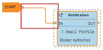

Creating an Alarm Pipeline​
Now, we'll access the Designer to set up an alarm pipeline and configure how and when alarm notifications are sent out.
  1. In the Project Browser, right-click on Alarm Notification Pipelines and then select New Alarm Pipeline. We will name our pipeline myPipeline.
  2. Drag a Notification block from the top bar down to the Alarm Pipeline workspace.
  3. Click on the Notification block to display the Notification Block properties in the Pipeline Block Editor.
    Creating an Alarm Pipeline Step 3
  4. In the Notification tab, click on the dropdown menu and select your Notification Profile. Ours is called Email Profile.
  5. Click on the Contacts tab and select the On-Call Roster we created. Ours is called myRoster.
  6. On the Alarm Pipeline workspace, connect the START node to the IN node of your Notification block, then save your project.
    Creating an Alarm Pipeline Step 6
Now that we've created an Alarm Notification Pipeline, we can use it on the tags we want to keep an eye on. In this example, we'll configure an alarm on the RandomInteger1 tag that's available from the Gateway's Quick Start resources.

We'll now utilize the Alarm Journal component we put on our project in step 2 of Preparing Perspective Components.
  1. Go to your Alarm Journal Table component.
  2. Change the name property to the actual name of the Alarm Journal configured in your Gateway. If you are using the Quick Start, the name should be Sample_Alarm_Journal_Profile.
Your Alarm Journal Table will now populate with the data from the Gateway's Alarm Journal. Further details on the Gateway Alarming settings can be found in the Alarm Notification section, while more information about alarm states, schedules, and usage with tags can be found in the Alarming section.

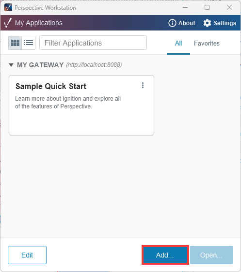

  1. Open the Perspective Workstation launcher we installed in the Downloading and Installing Ignition section.
  2. Click Add... on the bottom of the launcher.
    View Project Using Perspective Workstation Step 2
  3. Select the local Gateway, then click Select Gateway.
    View Project Using Perspective Workstation Step 3

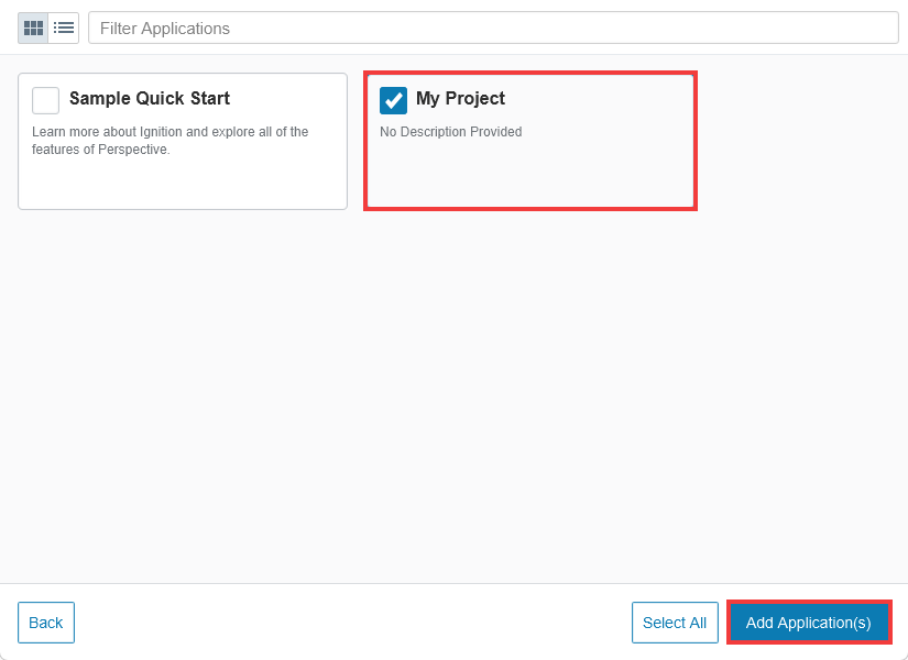

  4. Select the project we just created, then click Add Application(s). Your project will be added to the My Applications window.
    View Project Using Perspective Workstation Step 4
  5. Click on your project, then click Open....
    View Project Using Perspective Workstation Step 5
Perspective Workstation will launch your project and you can now interact with it as if you were an operator.
