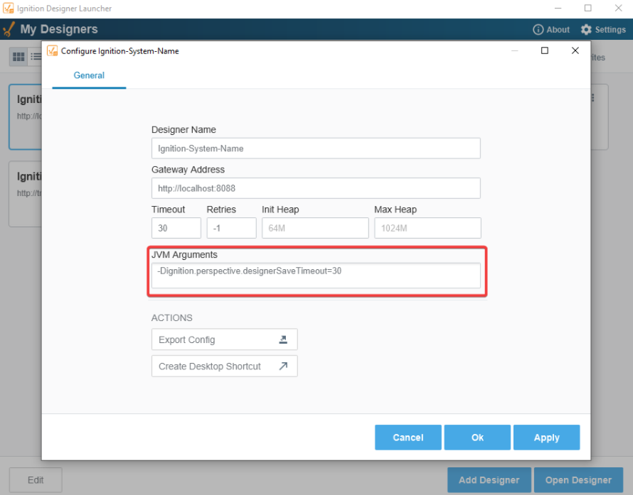

Designer Launcher Configuration
Designer Save Timeout
The following parameter configures the Designer save timeout when working with a Perspective Session. This parameter must be entered in the Designer Launcher JVM Arguments field. To access this field, click the three dots menu for the project in the Designer Launcher and select Manage.
| System Property | Description |
-Dignition.perspective.designerSaveTimeout | Specifies the time (in seconds) the Designer will wait for an embedded browser frame to return results. The default timeout is 60 seconds. |
-Dignition.perspective.designerSaveTimeout=30
