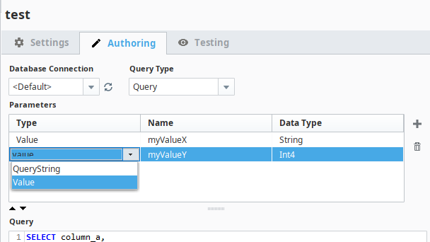

Parameters while Authoring a Named Query​
Creating Parameters​
New parameters can be created in the Authoring section of a Named Query by clicking the Add () icon next to the Parameters table.
note
In Named Queries, Parameters are referenced by their name, so renaming the Parameter will require you to update it on any other resources that are using it.
Each parameter has three properties represented by different columns in the table. These may be edited by double-clicking on the cell you wish to modify:
  • Type: Changes the type between Value and QueryString.
  • Name: Determines the name of the parameter, and how it will appear in the query. Names are not case-sensitive and must be unique. Additionally, they may only use letters, numbers, dashes and underscores.
  • Data Type: Specifies the datatype of the parameter. The Type of the parameter determines which data types are available. Note, that QueryStrings may only be configured as strings, where as Value-type parameters have more types available.
