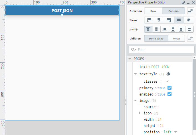

  5. Open a Perspective View and add a Button component. In this example, we named the button POST JSON.
    Add a Perspective Button

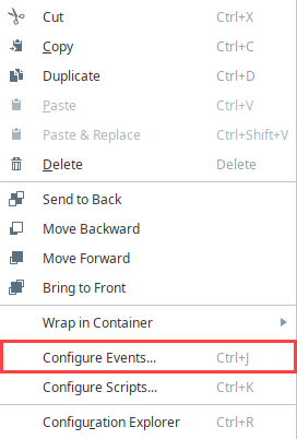

  6. With the Button selected, right-click and select Configure Events.
    Configure Component Events

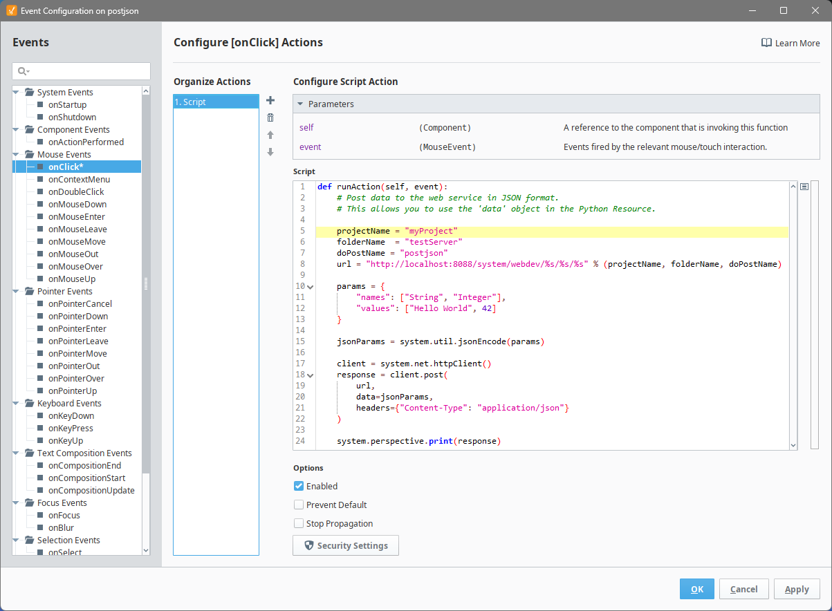

  7. Under Mouse Events, select onClick, then add a Script action. Paste the following code to send a POST request to your new endpoint.
    # Post data to the web service in JSON format.
    # This allows you to use the 'data' object in the Python Resource.
    projectName = "MyProject"
    folderName = "testServer"
    doPostName = "postjson"
    url = "http://localhost:8088/system/webdev/%s/%s/%s" % (projectName, folderName, doPostName)
    params = {
    "names": ["String", "Integer"],
    "values": ["Hello World", 42]
    jsonParams = system.util.jsonEncode(params)
    client = system.net.httpClient()
    response = client.post(
    url,
    data=jsonParams,
    headers={"Content-Type": "application/json"}
    system.perspective.print(response)
  8. Save the project.
  9. Open the Perspective Session and click the Button to send the POST request. The printed response appears in the Session Console, and the Gateway logs show the formatted data.

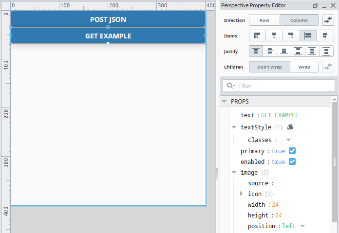

  6. To test the endpoint, open a Perspective view and add a Button component. In this example, we named the Button GET EXAMPLE.
  7. With the Button selected, right-click and select Configure Events.
