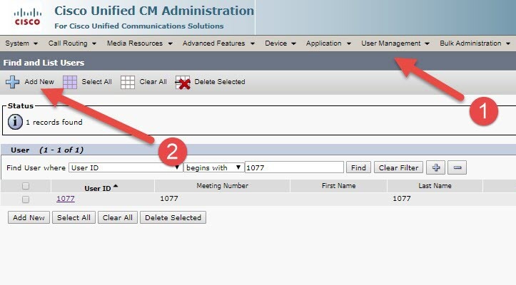

In CUCM, Under User Management, select End User then click Add New.

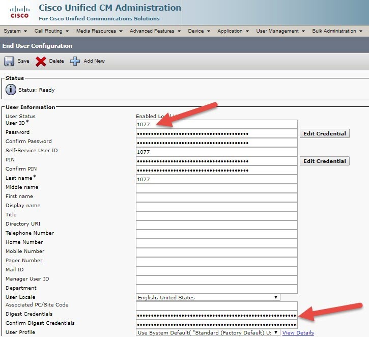

Create a user with digest credentials.
noteUse the extension as the username. Ignition will not register to third-party SIP if you are using regular characters.

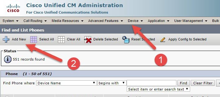

Under Device, select Phone. Click Add New.

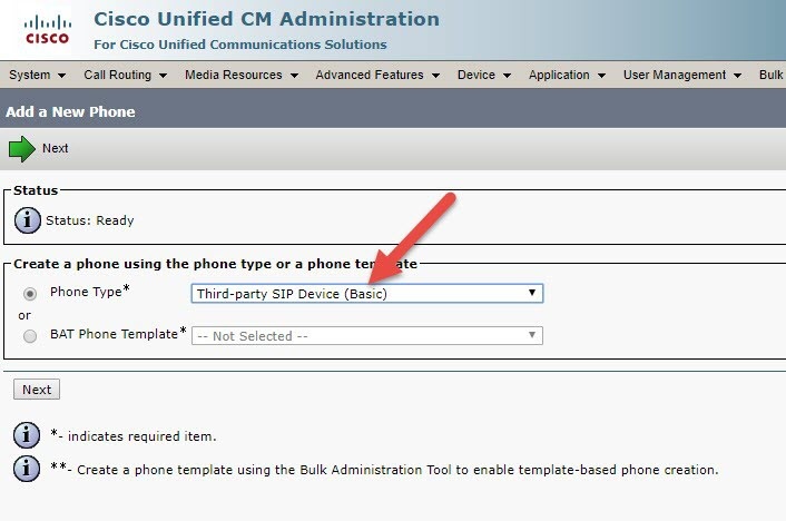

Select Third-party SIP Device (Basic) as your phone type.

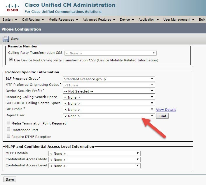

For phone configuration, configure everything as usual. For the Digest User, use the end user you created at the start.
noteYou do not need an actual Mac address, you can use 000000000000. Also you do not need an owner user ID. You would only need a digest user to register Ignition to CUCM.
noteDepending on your system, the Media Termination Point Required option may need to be checked.
For line configuration, configure how you would usually configure a line. You do not need a user associated to the line.
